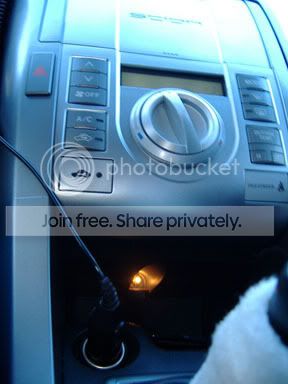

can anyone tell me if there is a replacement led for this bulb?
i dont even know what its called but heres a pic to show you which one im talking about

#74 is what your looking for,
get it in superbrightleds.com under automotive leds

go to superbrightleds.com and search for "T1.5" its the only T1.5 on the website. oh if you are going to ask how to take out the bulb, SEARCH. coz if you dont, you'll hear a lot of the "SEARCH button is your friend" comments. hahaha!

You want the #74 Bulb without the Twist Lock Base.
superbrightleds.com
For some of you who didn't know it was there; I bet the wiring is there, they just forget to install it. 2 ways to get to it; 1. Disassemble your Center Console controls (Radio, HVAC Controls and Shift Surround Pieces.) Or, 2. Pop out the clip in the rug by the Center Console on the passenger side foot area. After that, you can reach inside and feel for the wiring. Both take less than 5 mins.
