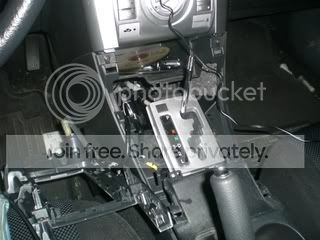

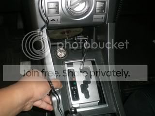

first off. i had to twist off my shift ****. and put the gear onto neutral so you can take off the center console
unlike the other link, yall sent me earlier, i dint have to unplug anything. wires etc.

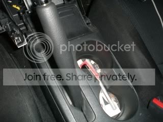

then, i took off the cup holder. was a lil tight. but i managed. pulling from the front end. and bottom side corners

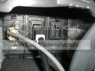

then i noticed two wires going towards the arm rest. the left one is the car power outlet, and the right one is the AUX outlet.
view from inside the arm rest. no u dont have to take out the bottom cover of the arm rest.

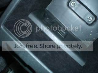

this is what it should look like under the center console connecting to the arm rest

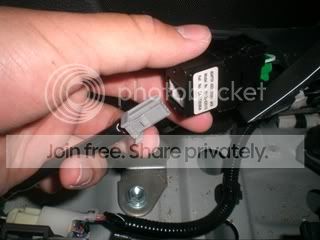

ok. i did it the hard way. but imma show u the easy way to take out the aux port. first unplug the gray clip that connects to the board
now push the board forward, until it pops out inside the arm rest
