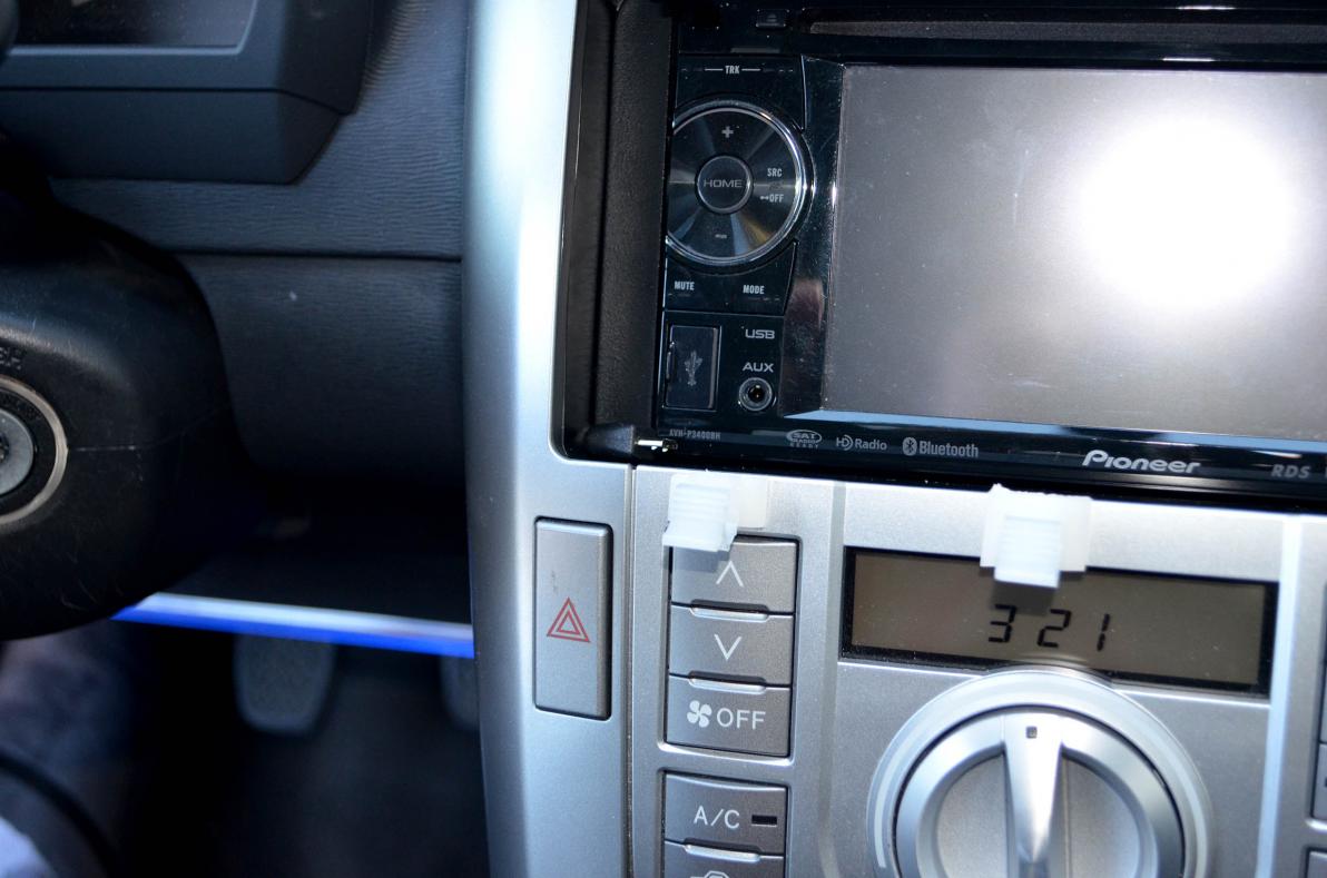

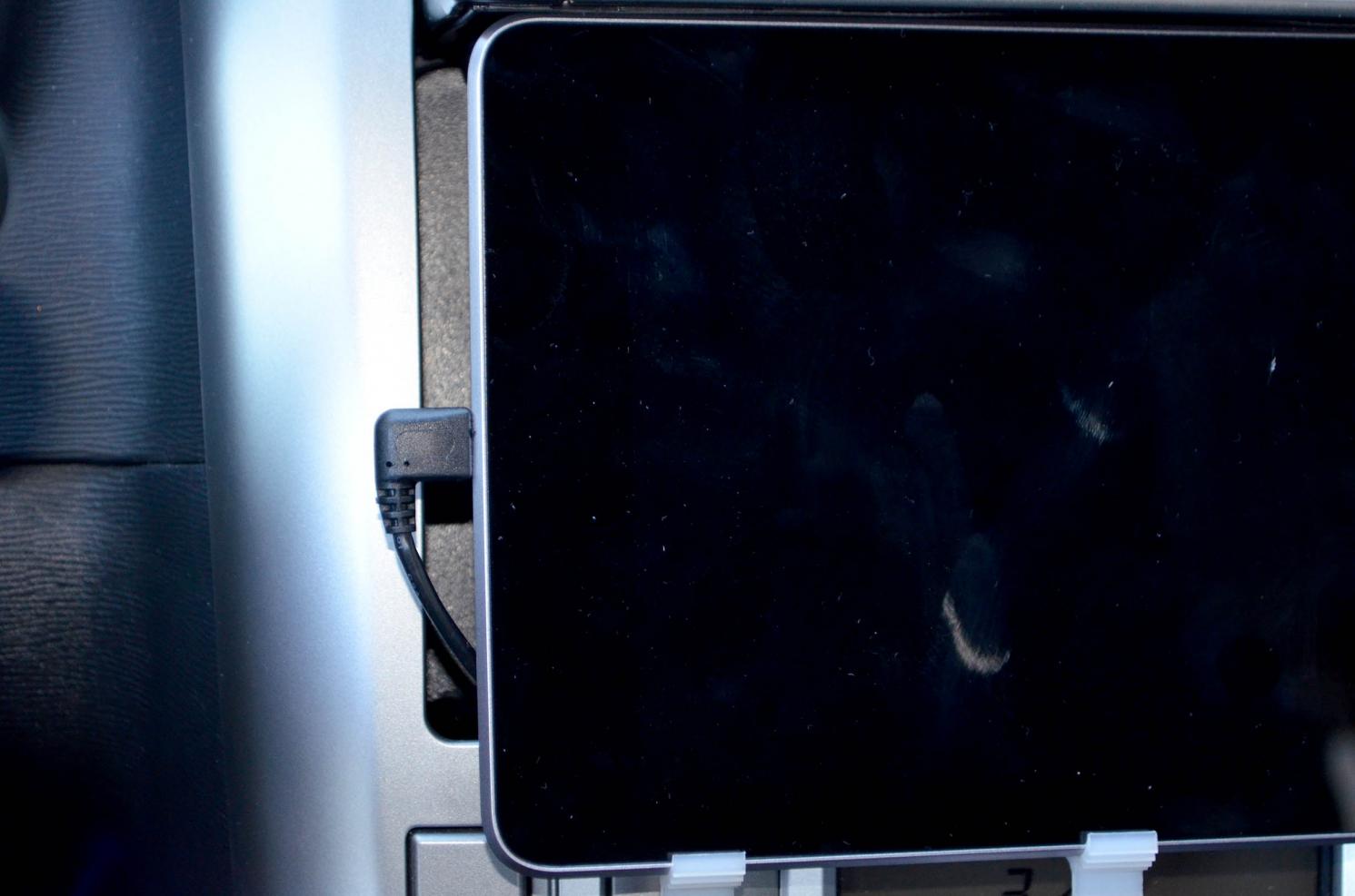

Originally Posted by tangsta35
In your setup, you would still require the aux input to go through the original head unit right?
What i'm trying to do is completely replace the factory head unit... but after doing some more research, i think another issue to consider is how to get the audio to route to the 4 speakers and subwoofer from the micro usb/mhl connection...
Yes. I've left the factory head unit. I still have the steering wheel controls for volume and I can listen to the radio if I want.
For me, it didn't make sense to get rid of it. You'll have to buy an amp and wire it all in if you intend to.
There are DAC's that work with the Nexus 7 if you want to output audio via USB, but if I remember right the N7 has to be rooted and I think charging was an issue. Bluetooth was much simpler.
Oh, and pics...
I just removed the radio cover, and placed the N7 in the hole.

I couldn't get the OEM cover to remain in place without doing a lot of cutting of the bezel, so I abandoned the idea altogether and simply removed it. It only had six screws if I remember correctly.
