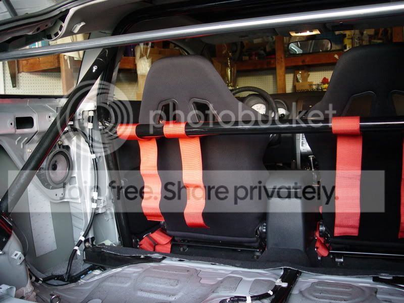

as far as i know the only harness bar available for the tC is from AutoPower Industries
but you have to get the roll bar inorder to have the harness bar
like previously stated above, you dont want your shoulder harnesses bolted str8 to the floor, in the event of a crash/accident you will cause serious bodily injury
same thing with the lap belts
heres a pic of my roll bar w/removable harness bar
but i could be wrong about being the only harness bar available, i haven't look around enough to know.
