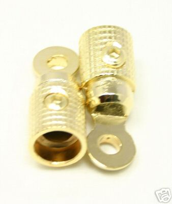

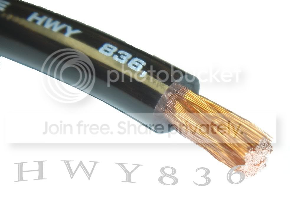

you need 4 awg wire for the + and - runs (i have 10 feet for each lead), an inline fuseholder, and a couple of 4awg ring terminals.

buy like 10 feet of 4gauge wiring for the positive, and negative, so 20 feet total...(got the info from Neothin, thank god someone spoke up! lol)
buy some 4gauge terminals for that wiring
connect those to the wiring you just bought
and take those terminals now and bolt them to your battery terminals that come from the car that connect to your battery..unscrew the bolt off, slip that terminal on and tighten the bolt down. now run the wiring under the car to the power supply, connect the +/-. and run an extension cord to an outlet and voila!
