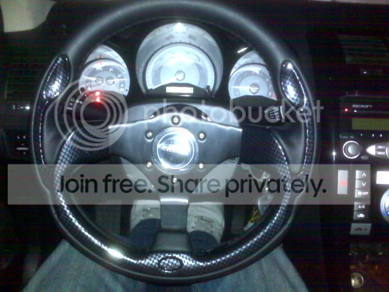

So I finally got my steering wheel on! I want to thank all of you for helping me out, I felt like such a newbie when it came to this stuff. I knew it couldn't have been that hard, but man! Thanks again to "hawgs74 ", "trialsindude", "himynameischris" and "pep20" You guys rock! Here is a blackberry curve cell phone pic!

Old Dec 7, 2007 | 07:24 AM
DarkSci0n's Avatar
Posts: 26
wow, gotta say it looks nice!
Old Dec 7, 2007 | 07:34 AM
BrownDogg's Avatar
Posts: 1,376
From: ASU, Arizona & SoCal
Hawgs... How did your wheel come out? Pics?
Old Dec 7, 2007 | 07:45 AM
AcidDrop's Avatar
Posts: 5,743
looks nice but seems like you struggled a few times but seems well worth it. let us know if it feels different driving around with it and did you compare it to the stock one in weight wise?
