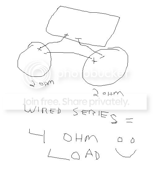

ur amp is going into protect mode and shuts off automatically to keep from frying its internals. just going off of what u said u have 2 2 ohm subs wired in parallel off a bridged channel correct? now when u bridge an amp the bridge channel is 1/2 the ohms of the stereo channel. 2 2 ohm subs wired in parallel will yield u 1 ohm but when u put that 1 ohm load to a bridged channel its actually .5 ohm only. that is y ur amp is shutting off and then coming back on when the internals cools down enuff. kenwoods are nice amps but they are notorious for this problem. only top of the line amps are .5 ohm stable when bridged so if u want to wire ur subs like that then i suggest u upgrade ur amp. if i were u i would wire the subs in series instead. (put the postive side from bridge channel to the + of one of the subs. then put the negative side from the bridge channel to - of the other sub. then put a wire connecting the + of one of the subs to the - of the other sub. here is a crappy diagram i did on paint. don't laugh. this should help u with ur problem.
...someone that KNOWS his "ohm's" - even the picasso rendition is done in detail! LOL! Honestly, great explanation tc-guy! Kudos!

thanks jls. i knew u all would like my chicken scratch diagram.
i have had the same problem with kenwood amps in the past. they sound great when bridged......until they shut off.
