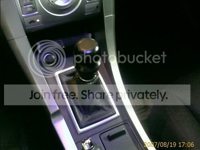

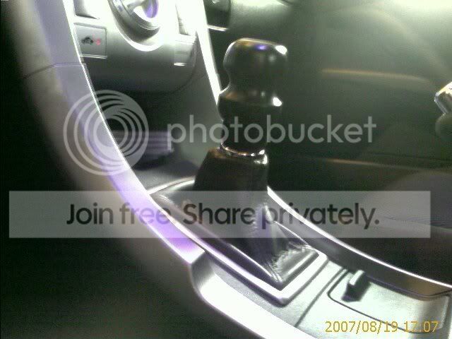

Taken on my cell phone camera in my garage, so the quality isn't the best (I must be the only person left in the world w/o a digital camera...lol)
This is my Doctor Isotope Gearswitcher @ 1.5" reduction with a waisted weighted shift ****. I didn't use the collar that came with the **** because I couldn't get the threads to catch as it sat up higher (I guess b/c it is a short shifter), so I didn't use the collar and it worked perfectly and am EXTREMELY pleased!!! Thanks Doc!
