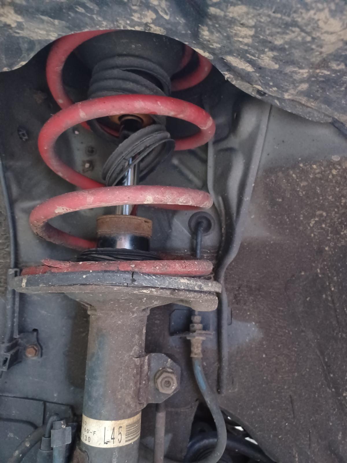

so this is what both front shocks look like! I noticed the other day that the hood was slightly uneven now from one side and told my husband that I thought it was a blown shock. He told me no way. Well, I was right and when looking for other problems he finally checked them and found this. How bad will replacing them be?

Can't hurt to replace them! Stay away from Monroe & Gabriel.
Some KYB quick-struts will be easy and you get back OEM springs. Lots of aftermarket springs aren't that good, so best to replace them too.

Hard to tell from the dust shields if the shocks are done, but if they're original from 09 they're probably well-past their lifespan. If it's an RS model you have, I believe those should come with the red TRD springs, which will be fine to reuse. They're pretty easy to replace using spring compressors and an impact if you wanted to keep the ride height, but might be best to take it to a shop if you're not comfortable installing the parts yourself.
I will say they are not leaking fluid so I feel that's a good sign but, I think the pressure from the struts has taken the driver side berring as well. I'm going to do the work myself with the help of a friend mechanic at this point since I'm so scared I'm going to screw something up. 😂

Again, hard to tell from those pics. All the fluid could already have leaked out. Looks like there is residue on the shock but hard to tell if it's old oil or just road grime.
Definitely could be a wheel bearing, but since you already ruled it out in the OP I didn't suggest it. The shaking + humming leads me to think it is a possible cause of the issue as well.
