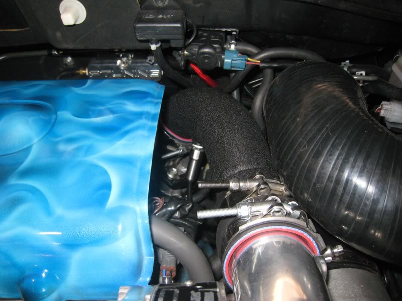

Finished doing the wrinkle finish on the charge pipe, I think it turned out well. Should be getting tuned very sooned.

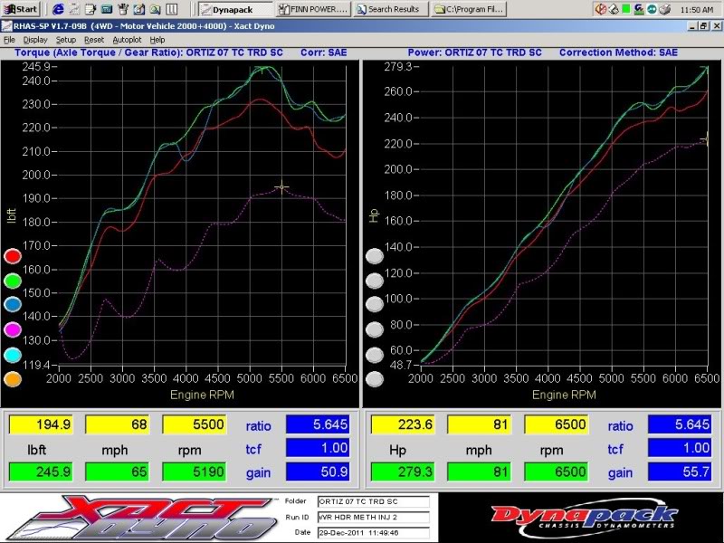

I FINALLY got retuned with my new goodies on. I didn't quite make as much power as I was hoping but still happy. I do need to swap plugs out since I was running a step too cold. End of the day sitting at about 280 whp.

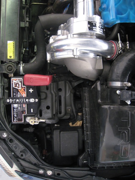

I have begun my next project, I have been thinking about this for over a year on how I would go about pulling it off. End goal, water to air intercooler. Many others have tried this but I only know of TRD pulling it off. I looked high and low for an off the shelf one but non would work cleanly so I am ordering a cutom one that will go in the same place as the TRD version.

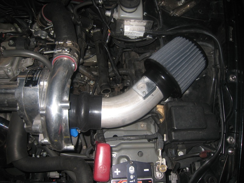

To clean up the engine bay I have gone with a Braile battery to bet room and to open up the intake to the full 3 1/2 inches the blower has as an inlet instead of the 2 1/2 inlet on the stock intake and even smaller on some aftermarket ones.
This is something I plan to have done before the end of the year. Little taste of where I am in mock up for intake an have laready mocked up the intercooler. Name:  8a410aa3.jpg
