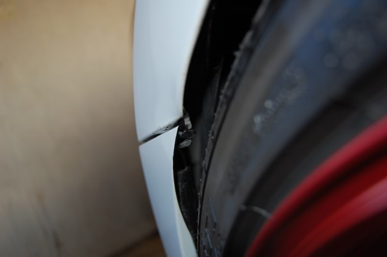

Let me start off by saying I am lowered on raceland coilovers. Every time i hit a small bump in the road my tire rubs on this bolt that holds the bumper in place:
Does anyone else have this problem, and if so, how did you fix it?

yes all the time. Also that front bumper lip on mine is shaved down from the tire rubbing on it. What I did was just hammer it upward.

Oh okay. I think I'm going to try to grind off a little of the metal to make it less protruding.

Yeah I just hammer that part up.

What i did was just reach under the fender and just pull it up a bit. worked great.

Just solved my issue! The metal fender tab ended up cutting my tire a little bit so I figured I need to move that out of the way. So I removed the bolt, took off the corner of the bumper, bended the tab up then re-secured the bumper using a zip-tie. Just tested it and it works!
