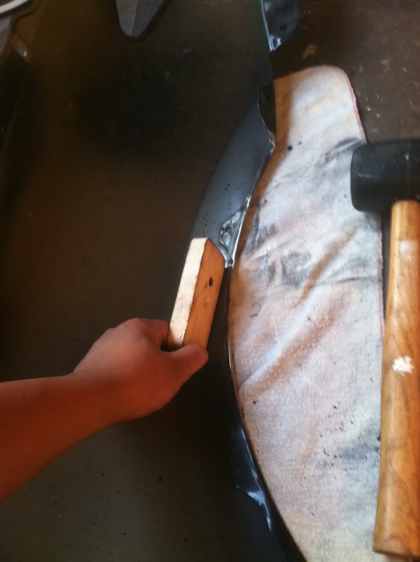

so remember this?
well, i finally got around to fixing it. well, sort of.
basically, you need a rubber mallet, heat gun, a soft clean towel, a small piece of wood, and a flat surface(i used my floor)
first you need to heat the outside of the fender to prevent the paint from chipping off when your hammering away at it.
then, flip the fender upsidedown so youre hammering from the inside. place the towel on the ground so you dont scratch the paint. MAKE SURE the towl is clean or else dirt will be imprinted onto the paint of your fender.
this is when you use that small piece of wood. use the flat edges of it to flatten the dented parts of the fender.
this is the finished product.
its completely flat now. not more dent. only thing is the paint is still chipped off from before. but ill deal with that later.
