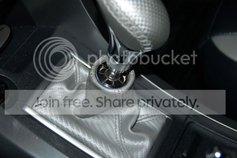

I just replaced my stock shift **** with a cool silver "carbon fiber" leather one to match my custom interior. The problem though is that this doesn't sit as low as the stock and now there's this huge gap. The **** isn't a Momo, but it's similar, so it uses allen bolts to secure at the bottom and has the screw on ring at the bottom. What can I use to get the boot up to the shift **** to remove the gap? Is there something which would replace the holder in the boot and possible the screw on cap at the bottom of the ****? If there's something out there which would allow me to pull the boot up a little and screw onto the bottom of the ****, that'd be perfect.
Suggestions?

You might be able to push up the boot if you can get underneath it and see if there are some adjustments.
Some people cut their shaft (no, I'm not talking about a San Francisco man). I had a buddy who did that. He bought one of those shift ***** that look like a toilet paper roller and it looked like he had a broomstick as a shifter. He cut it about 2 inches and it looked slick after that.

Yeah, mine was cut about two inches also. It looks taller than it had before with this ****. Not sure if I like it just yet. Maybe one of the ball ones would be better.
What kind of adjustments would there be under the boot?

I haven't seen it myself but it's probably a ring that sits in a groove to hold the boots position. If you can't move it up, perhaps you can get a dremmel, create your own groove and set the boot's ring there. It's a pain, that's why I don't change the ***** in my cars.
If you get a ball, you'll wind up with a larger gap since ***** don't have sleeves like the more "traditional" shaped *****.

flip the silver ring thing upside down :D same situation happened with my shifter, if you inver the ring
the one with the holes in it, flip that and it will fill the gap and look 100x better

IIRC I had the same problem in my last car. I looked down in the shift **** where the shifter gets inserted and saw there is actually a "stopper" before the actual height of the ****, I ended up drilling it out. I really dont know how to explain it, but after drilling it out the shifter itself was actually touching the inner top of the ****. Like you said its not a screw on so it most likely has the same symptoms as I'm describing.

Thanks everyone. I removed the center console piece, inverted the "silver ring thing" and VOILA, 100% better!
