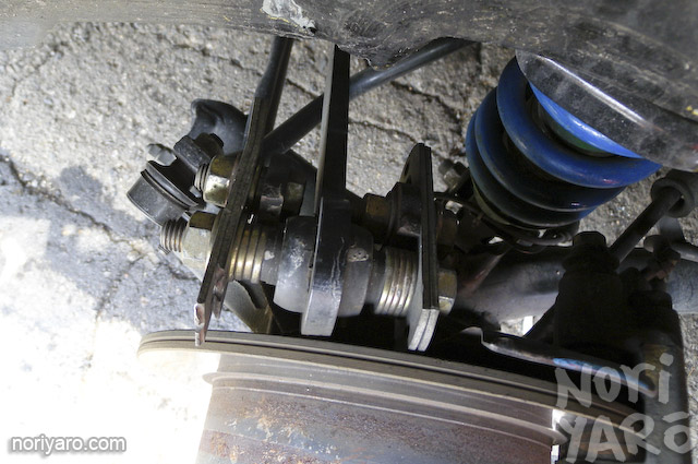

Id recommend you just save up and get hotchkis camber arms, they're totally worth it. Those got me at -11* with some modifications. But if you're on a budget, you can try something like this lol

Without any modification, I maxed them out at -7*. For more you simply remove jam nuts and screw the shaft all the way in, that should get you up to like -10*. For some real demon camber you shorten the shaft by 1/4 to 1/2''. This is not even maxed out, so i put 1 of jam nuts back and i'm limited by inner wheel clearance now.
Front, I have 2 sets of camber bolts and camber top plates, maxed out at -7*. Idk if your coils have camber plates or not, but 2 sets of bolts can get you -4.5*.
