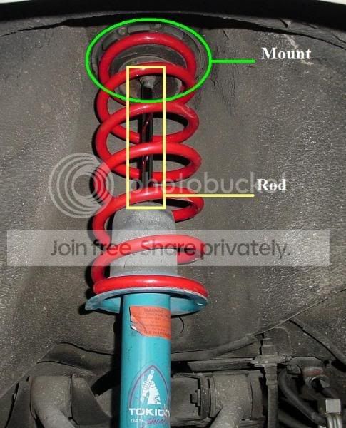

Just in case visuals are needed... I didn't have my camera with me when the showed me what the deal was, but I will attempt to show it using this MS paint diagram (you may have to use your imagination haha):
This is just so you know what parts I mean when I say mount and rod.
Basically, this is what is happening. With the interior panels off and the strut mounting locations exposed, you can see the top of the strut (aka the top side of the "mount"). As the strut moves over bumps and whatnot, the "rod" can be seen coming up through the mount. In other words, there is nothing stopping it. The rod is visible in the cabin when the shock compresses. So, because there is nothing to stop it, when the "rod" comes up, it hits the top grey area in that picture, which in reality is the car itself. It's as if the "rod" doesn't have enough room. That wouldn't make sense, though, because the stock shocks had no problem. And, like was said before, the mounting location is very self-explanatory. Any ideas as to why the "rod" is doing this? Again, it's on both sides, so I don't think it's a shock-specific problem (unless I somehow have the rear shocks for a car other than the tC). Thoughts?

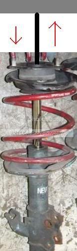

Here's a pic of what looks like Progress coilovers with the stock upper mounts installed on them, but you get the idea, see how the two rear upper mounts are? The rod should be bolted on to the top of the upper mount and shouldnt be exposed.

What type of upper mounts are you using? Did the shop use the upper mounts from your stock struts? Because if the stock upper mounts were installed on the struts, it should not have that problem because the rod is bolted on to the top of the upper mount and there fore would not go through and hit the sheet metal.
