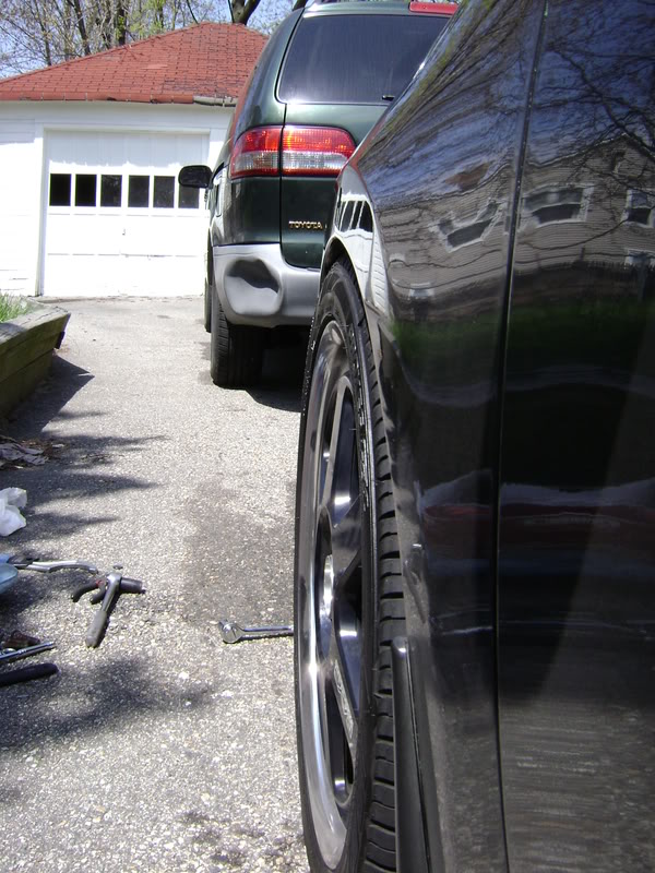

i think the camber i suggested is mild, here is an idea...
this is -2.5 up front which isnt bad at all. now im DUMPED on zeals (probably close to a 3-3.25 inch drop) and yes i rub and this is with 19x8.5 et 47 not really that aggressive but due to the fact that they are 19s and im so low, it was hard to turn and did rub (doesnt any more i raised it up .5 inch and i also brought the camber in to -.6)
this is 18x7.5 et 23 with 0 camber up front.
this is with a mild drop on H&R coil overs, only rubbed on harsh bumps (believe it or not) this is also with 225.40 tires with 215/35 i would have been mint. this is probably the closest set up to what you are takling about.
imo very flush, and with the right size tires and the right camber dialed in you'll be fine.
thanks for the info Dave and yes the 2nd pic is ultimately what I would like to achieve. I checked the offset calculator and +25et with 8.0 will sit very close to what you had there. and you said no rubbing? even in the back? Do you have any more pics of that setup?

rubbing was very minimal only on harsh bumps, and if you get coil overs, youd be crazy to not get the +25's
rubbing was the same front and rear, but once you roll the fenders rubbing is pretty much gone in the rear.
tire ware ultimately depends on toe. if your toe is in check then you'll be fine. you really dont wanna go too crazy on the camber unless you have to, -2.5 is good
