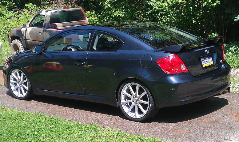

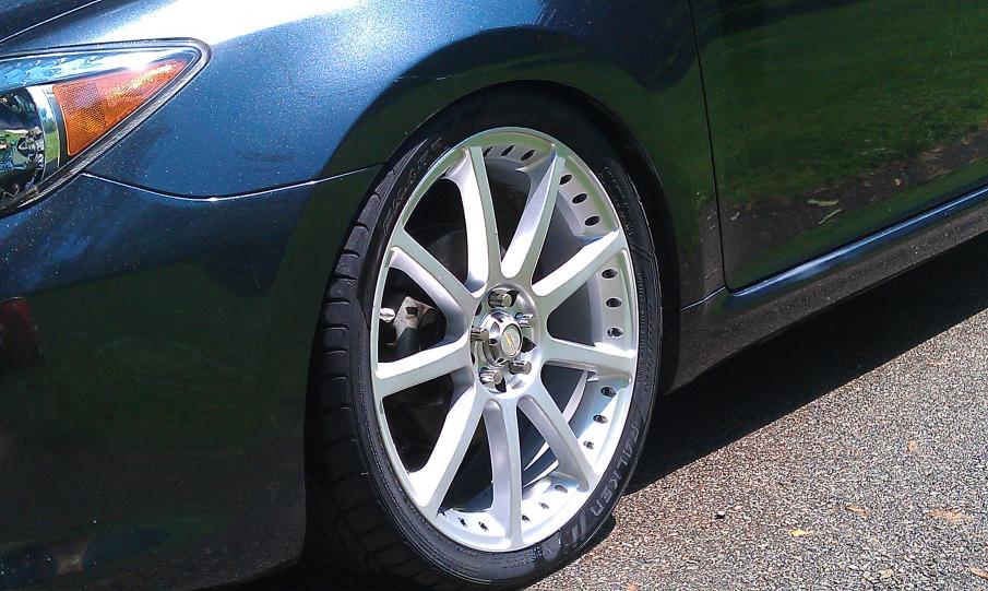

Wrapped in 245/35/19 tires... I rub a tiny bit in the front on bigger bumps. Luckily it is only the liners. My car is lowered 2 inches also...

Looks pretty good, which model Falken tires are those?

^Looks to be FK452.
Regarding rubbing on the liner on bumps if you don't want to take the liner out put a heat gun(at 200*) to the bump on the liner where the fender and bumper meet and push it in. I did that and the tire rubs if I hit a bump while taking a turn(the tire used to rub on that even going over bumps driving straight).

OK cool... I will heat them up... Thanks for the tip...

very nice looking wheels.

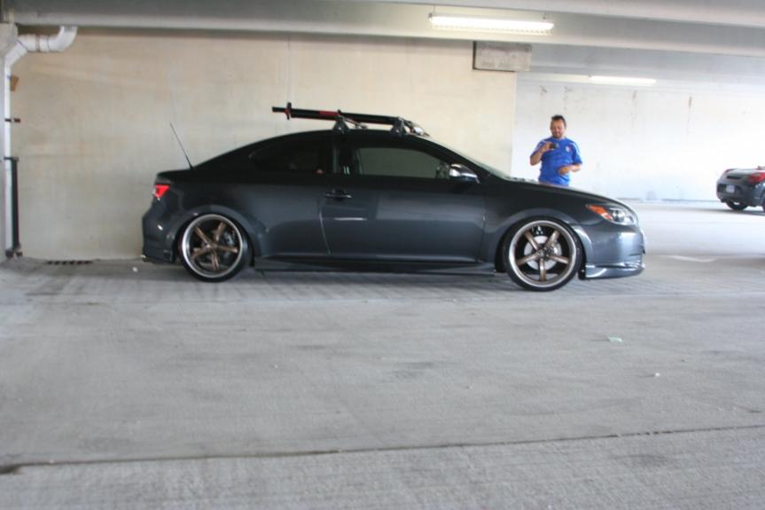

Default here is how I roll on my 19's
this is what my car looks like on 19's
