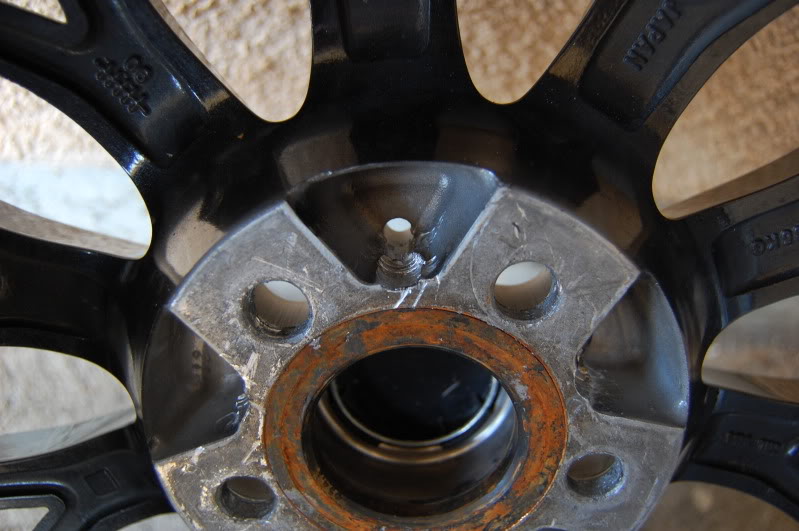

im having a problem with my 15mm bolt on spacers, after bolting up the spacers on the factory studs i put on my wheel on the extended studs on the spacer and my wheel doesnt sit flush against the spacer. i found out its because the factory studs stick out too far and hit the back of my wheel causing a gap between the spacer and the back of the wheel. anyone else have that problem? im thinking i have to chop down the oem studs to get the wheel to sit flush. any advice?
Old Feb 14, 2010 | 05:28 AM
dqlostsoulz's Avatar
Posts: 4,716
From: Californication
Yup I had the same problem too. Do your wheels have the slots on the back of them? Mine do and still the oem studs did not align into the slots they were off by a bit. But I made it work. I put the wheels on the spacer and tighten them up as much as i could, than I removed them with force and the oem studs marked my wheel where it hit. So what i did I got my dremmel and shaved that part down and after a few times of on and off and trimming it, it sat flush with the spacer. Or you can cut the oem studs thats what blktc did. Or you can get 25mm spacers and that will cover the oem studs completely.

Old Feb 15, 2010 | 02:13 AM
Posts: 4,716
This is what I did to mine to make it work..
