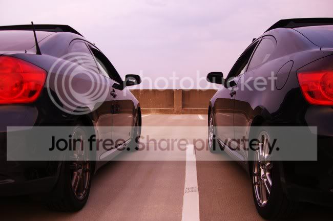

painting is fun... ive done it 2 colors, bronze is my favorite :D
i thought about doin green im not gonna lie

I like that.........any more pics of bronze???? what type of paint and how much

i didnt powder coat i used spray paint... lots of it lol. lots of sanding and lots of prepping., cleaning. all that good stuff.

yup
i went to autozone and picked up SEVERAL cans of BRONZE WHEEL PAINT by duplicolor, and a couple cans of clear, 600, 800, and i think either 1000 or 1500 grit sand paper, this stuff that smells bad for cleaning all the sanding dust off, and err... i think thats it... lots of free time too. it might be a good idea to pick up a can of primer... although you dont have to.
just sand the wheel down wiht 600 grit paper first to scuff it up, then sand with the 800 to get rid of the lines from 600 (or you could just skip the 600 step lol), then clean with the smelly stuff (sorry i wish i could remember what its called lol), let AIR DRY for about 20 min, then lay your first coat of paint (make sure to use THIN coats to prevent running), the paint drys really fast which is one of the many things i like about it (another being that its VERY VERY durable paint, i was surprised), 10-15 min to dry, then another THIN coat... i did about 5 or 6 coats becuase i wanted the bronze to show really well... then i waited about an hour to make sure the paint dried well, then started clearing. after about 2 coats use the 1500 grit paper and wetsand in between clear coats to get a nice shiney wet look to the wheels... all in all i put about 4 coats of clear on each wheel. and they hold up great :D im proud of them... ill probly redo them after winter.

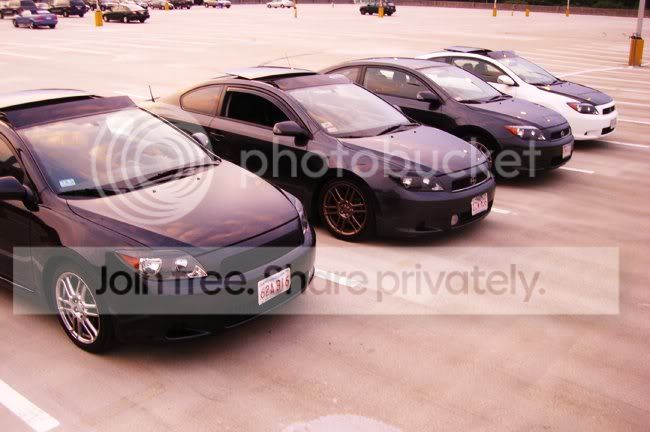

Old Sep 27, 2006 | 02:40 AM
davedavetC's Avatar
Posts: 20,410
heres a weird angle comparing to stock wheels
guess which is mine haha (hint: only one with bronze wheels)
damn i miss that exhaust....
