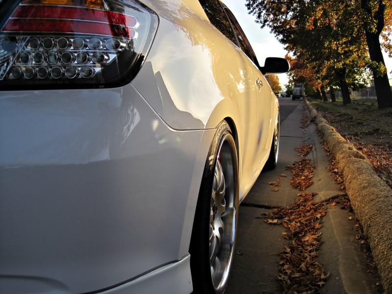

Front 19x8.5 et30 tires 225/35/19 Rear 19x9.5 et40 tires 235/35/19...what do you guys think add 15mm or 10mm to the rear and maybe 10mm for the front??

15mm all around.. :D

really all around...wont that be a lil too much for the fronts?

15 would be epic, that is too much imo

You think? I am actually leaning towards 15mm for the rear.

15mm in back more camber...10mm in the front

meant 15 would be too much for the front but back that would be good, would knock the offset down +25. Would look good with some camber.

Thats what I was thinking. Do you think I would need a front camber bolt and rear camber links?
Yup, how hard is it to adjust the camber in the rear?

Not hard but I'd say have a shop do it. Don't forget that if you have a wider track on the rear than the front the car will understeer more than it already does. If anything go with an even spacer all around
