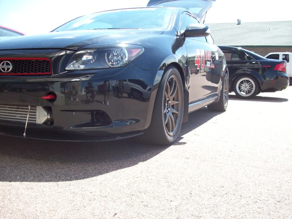

I have fit 17x9 +44 with 275/40/17 V710's, which run even wider than what they say. I ran -1.8 degrees negative in the front. I would look for lower offset though, as it will get close to the strut especially if you dont have camber plates.
This is what it looked like:

Originally Posted by rougenite
How do your tires handle the boost?
So how much lower of an offset? I love how yur car looks with those tires btw....slightly tucked or straight flush?
No camber plates yet....by that's why I am asking the questions....justto see what I will need to get a decent tire on this monster
The tires, being slicks, handled boost amazingly. Sticky tires like that allow even a pegg-leggin over-powered front drive to to un-holy things lol
Without camber plates, you run the risk of the tire hitting the springs. Camber bolts will not help, they will only make it worse.
I would try and get around a 35-40 offset, it would allow more clearance from the strut and other things inboard. I also have my fenders rolled and pulled to accommodate those tires too.
