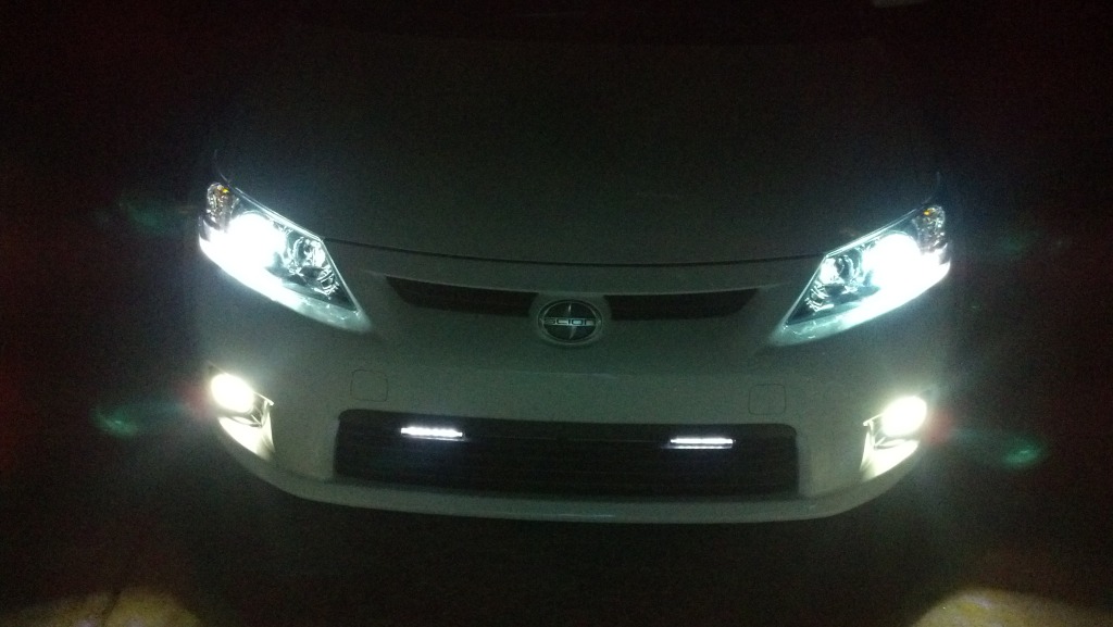

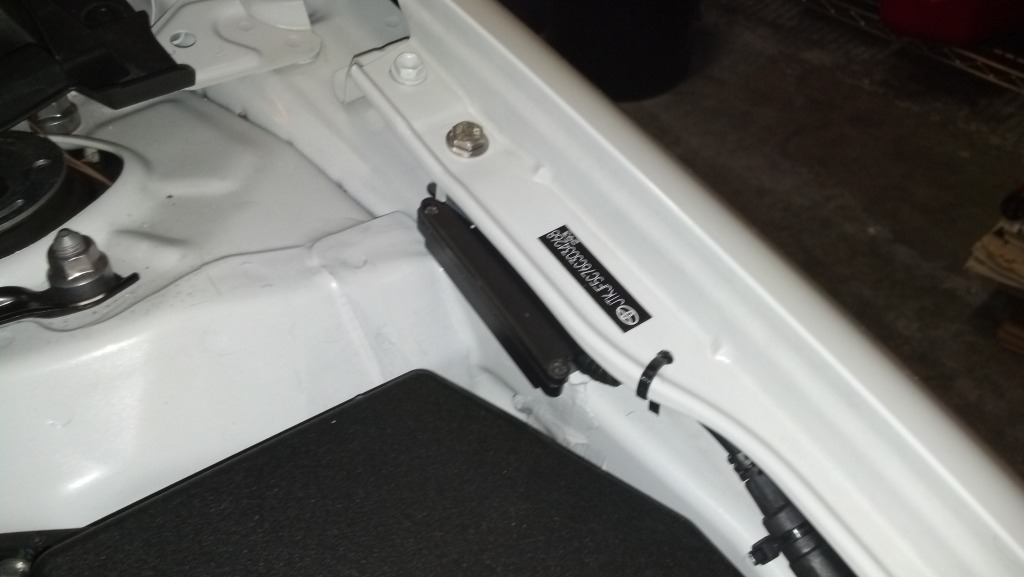

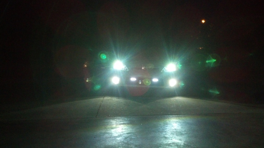

DDM Kit arrived today! Much faster than I expected. Ordered on the Sept 18th was processed and received an email from DDM on the 20th, arrived on the 30th. 12 days total time from order to delivery! Not bad.

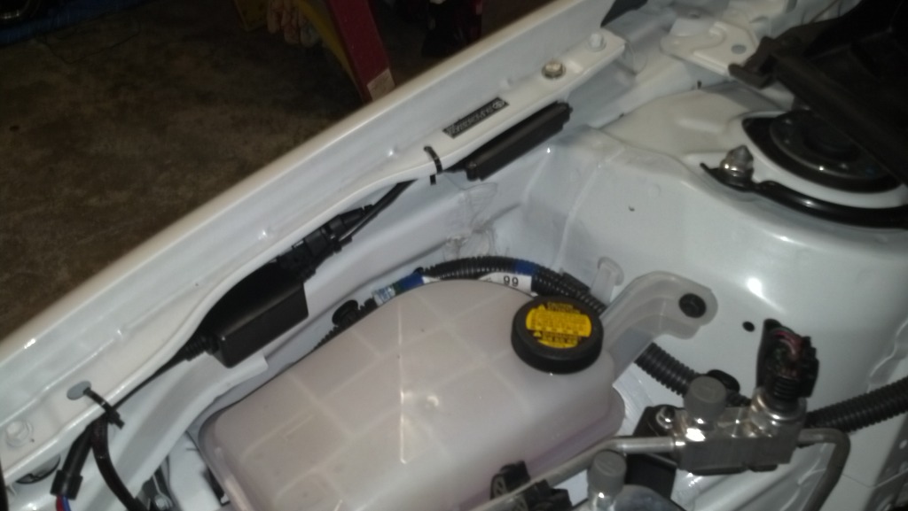

Installation was a breeze. Used the slim ballast brackets and mounted them along the fender using existing holes, dynamat on the fender, then stainless steel bolts, drilled a small hole for a zip tie to hold wire harness up. Everything went perfect, no flickering, quick warmup to full brightness.
Definitely brighter than the stock bulbs but the color and light difference is going to take some getting use to. Really like them so far, they look great with my LED, DRL's and Park lights, wondering how they'll do in the rain and different weather/light conditions.

One other note, they ballasts do get warm to the touch but not so hot they burn you.

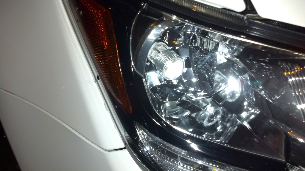

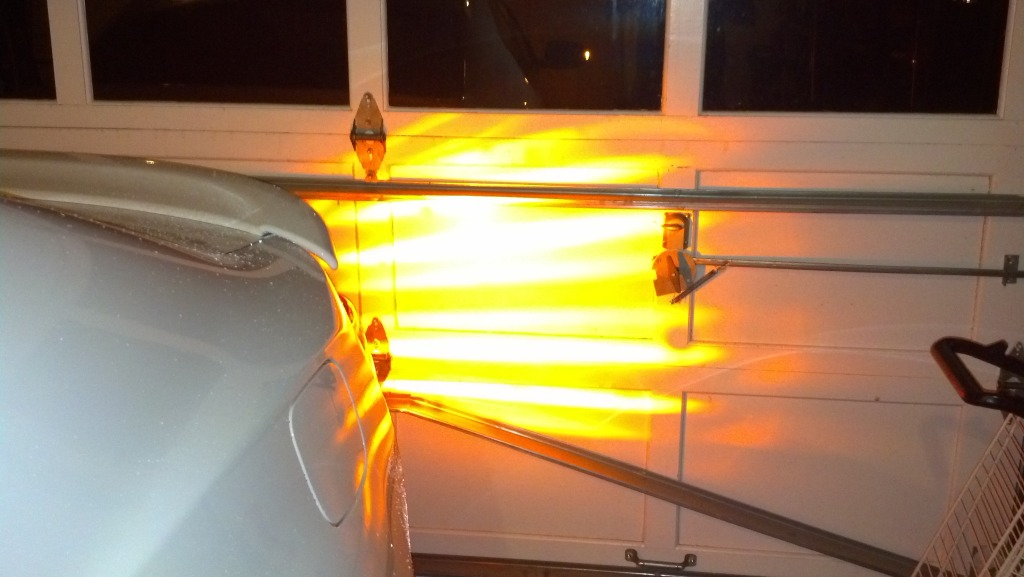

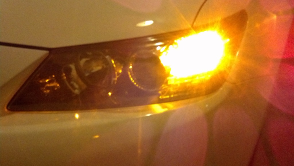

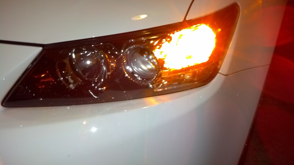

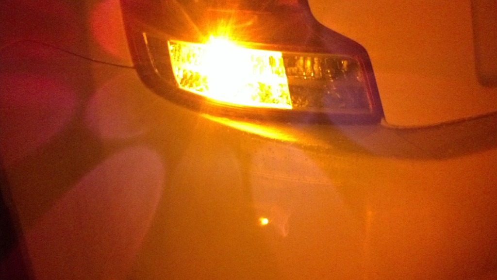

4 Cree Q5 + SMD Turn signal bulbs came in today from JLC Lighting, $54 shipped. Very nice, BRIGHT!
Installed the Tridon LM449 turn signal flasher from Autozone $20 bucks, no hyper flashing, works perfect.
Very happy with the price and fast ship from JLC, good quality bulbs, very bright!
