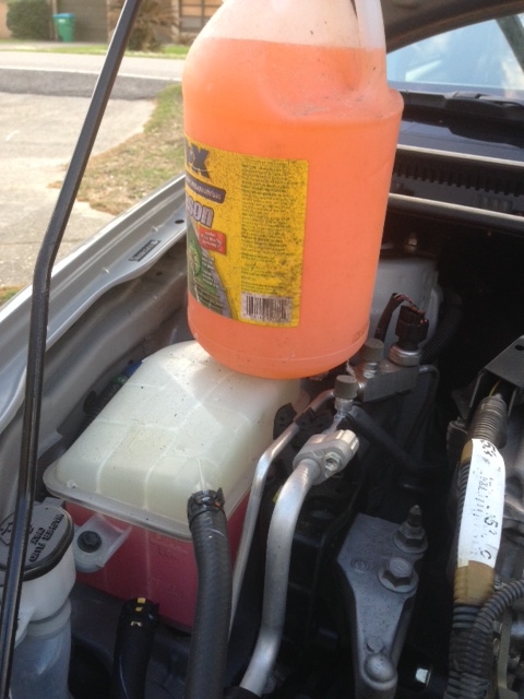

Well fellas. Just waiting for the engine to cool down a little before I go touching stuff.
Here's one thing I did find though
This is a picture of the coolant reservoir, and it appears to be bright red
I put the orange windshield wiper fluid just to create a contrast between the hues.
Maybe what the guy saw was indeed coolant coming from under the hoses? I'll know shortly.

Yeah, I dipped out yesterday, sorry man. But yeah, coolant is pink, not to be confused with red trans fluid. Remember, I said RED RED, not "mehhh red...". It's RED RED, and after 50,000 miles it would be brownish red. A flush will do you no good. There's no reason to flush it. Nothing happened except a super super slow leak. So the mechanic might have thought it was transmission because it's where they meet? I don't know. I see the drop and it looks pretty dark, but so does everything wet substance on dark metal. So wipe it up with a white towel and then take a picture. If it has any red qualities, then it's transmission. If it's only brown qualities, then it's oil. Take it to the dealership obviously and don't tell them anything about the wreck.
