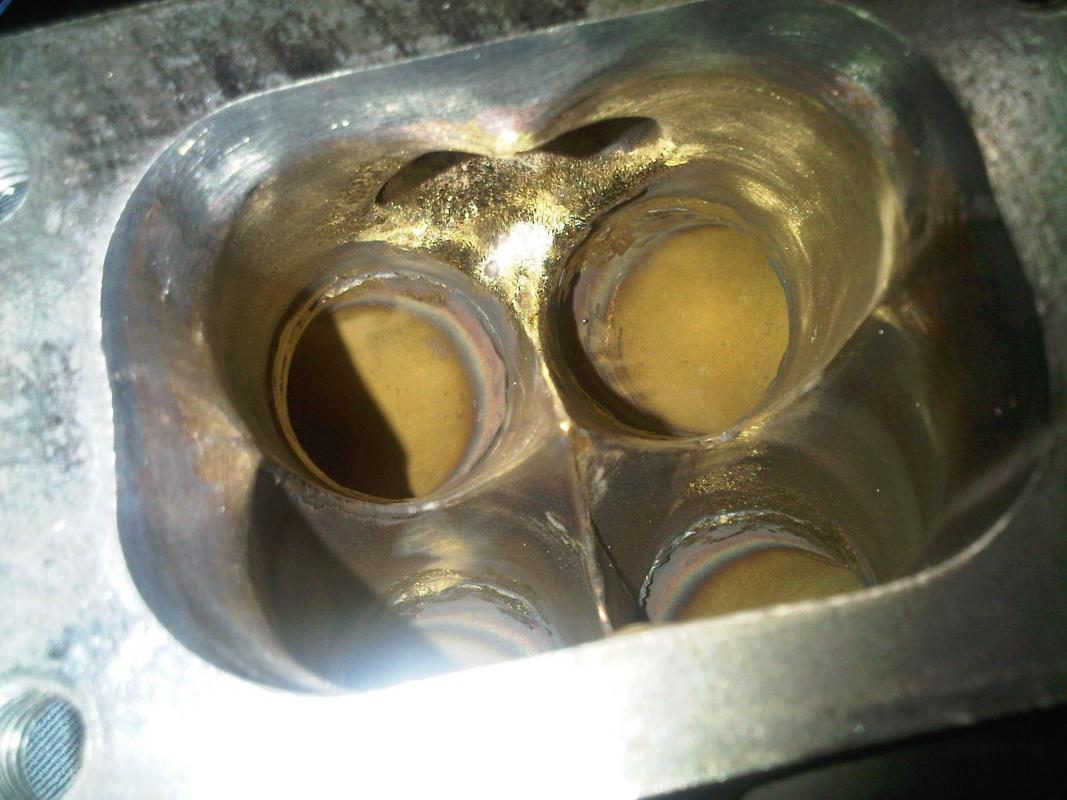

paul_dezod's Avatar
Scionetics
KAD
Posts: 11,936
From: Western NY
Originally Posted by HOODedDutchman
Hmmmmm that gorgeous header may have me rethinking then.
You mean this sexy turbo manifold?
