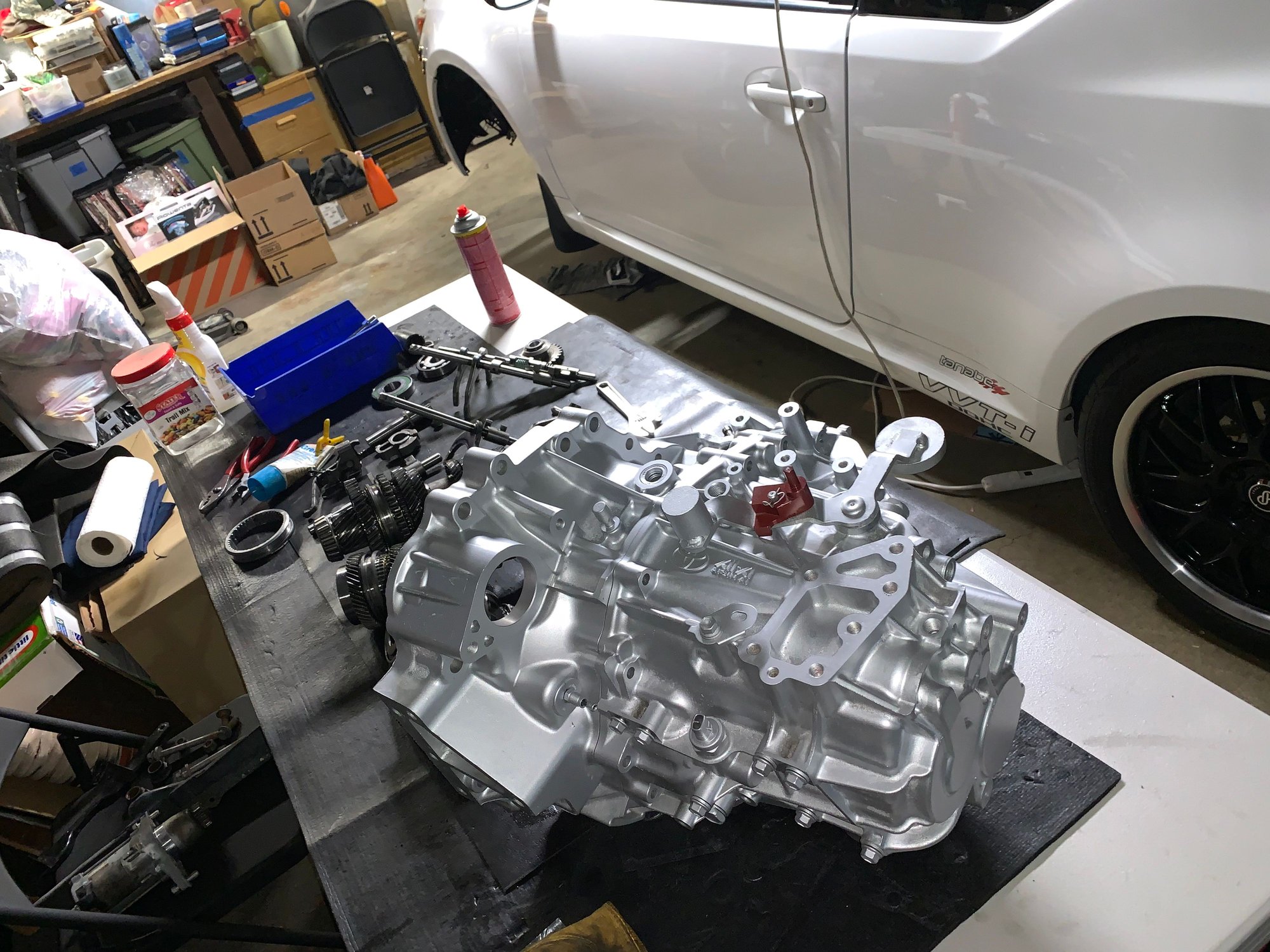

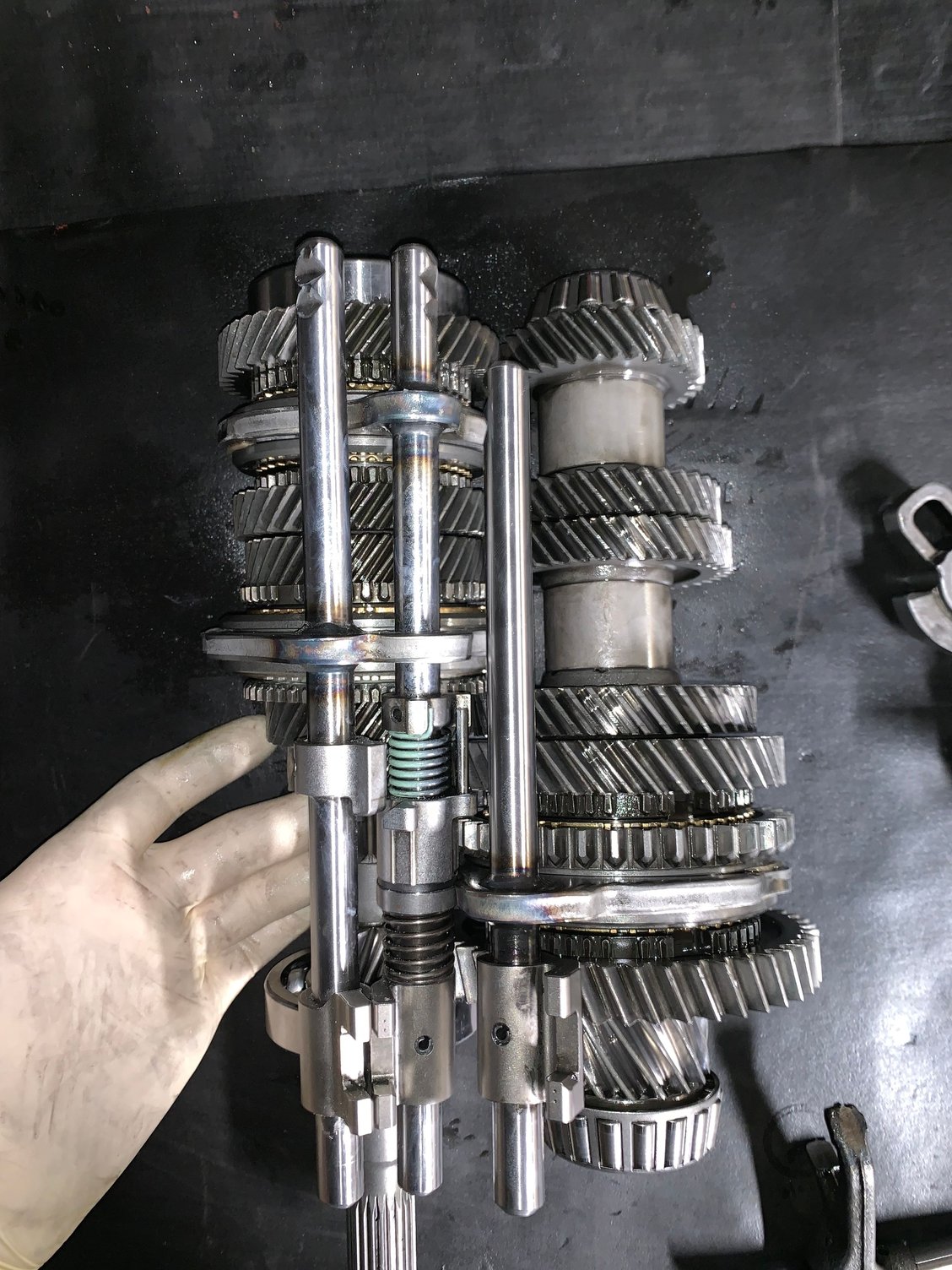

So update: I've got the trans case all open, but I'm not sure what bearing I'm trying to replace. Is it the green one right up top? And if so how do I go about removing it?
Old Mar 12, 2019 | 12:48 AM
MikelMykelz's Avatar
Joined: Jan 2019
Posts: 46
From: California
There is a snap ring above it, ( that is one of the non-reusable parts,) you have to use snap ring pliers to expand it off the shaft groove- And, also you have to get under it ( the bearing and between the gear and use something close to the shaft),
but don’t rub against it-(the shaft) to pull it off. Look up “bearing splitter” on line, because it allows the tool to angle between what needs separated. That is what I used to act as a aid to help remove the bearing.
This also helps to remove the gears as well to get to the last shaft bearing that is pressed on.
PM me if you need more help.

Perfectoo! Really appreciate the pictures. I just decided to pay 20 bucks for a local mechanic to take it off. Gonna take some measurements and see inside the bearing to see whats up and possibly why it keeps failing!
