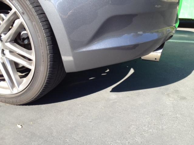

I ordered a Megan Racing Axle Back exhaust for my 2011 tC.
Install was extremely easy
• Didn't even need to jack the car up
• Two bolts holding the stock exhaust to the mid pipe
• WD40 to the bushings allowed them to slip off the hangers with ease
• Megan exhaust fit in perfectly (used the included hanger & one of the originals)
• Total install time ~10 minutes
Exhaust looks really good (great product). Sound was mildly more aggressive than the stock exhaust. Removed the silencer and minimal increase in sound.
That said, there is a noticeable increase in throttle response and when at full chat, you can hear a little snarl from the exhaust.
Overall, pretty good investment. I'm now wondering if I should replace the stock catalytic with a sport CAT which would definitely increase the exhaust note. Anyone have experience and recommend a sport CAT? And yes, I live in California.
