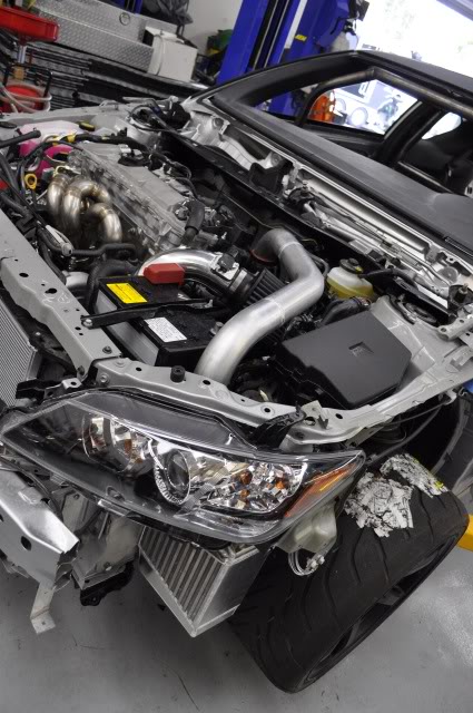

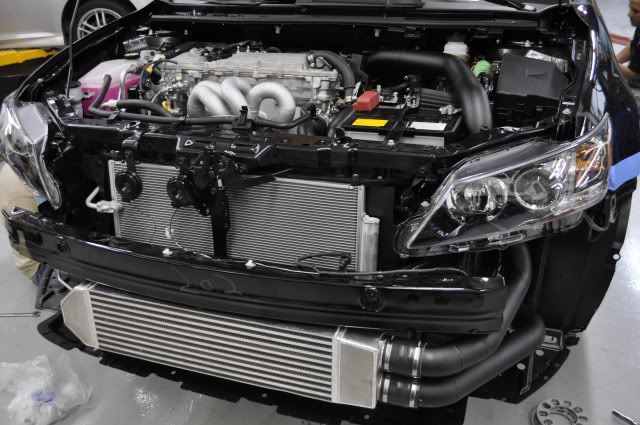

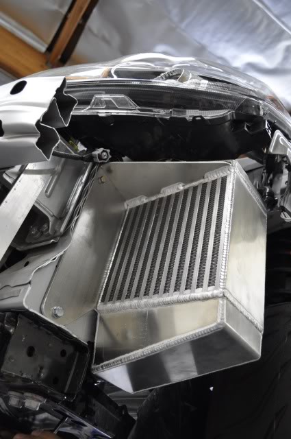

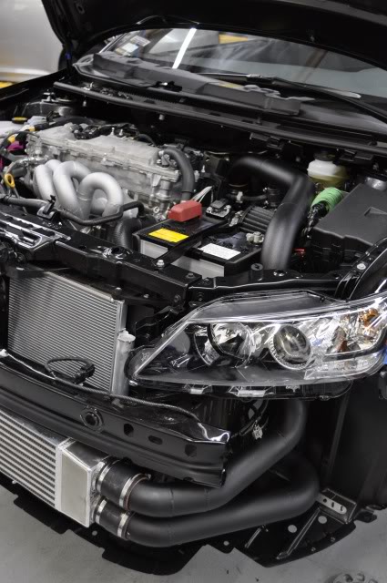

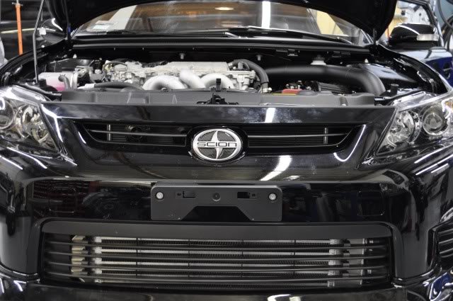

Here is some pictures of both of the new 2011 Scion tC DESCENDANT Turbo kit intercooler set-up's.
Stealth Side mount intercooler

Front Mount Intercooler

Anyone heat soak from the side mount and wats the core on the front mount and hp rating on the fmic can this one handle 600hp without major soak im not going for 600 but i want breathing room im lookin for 460-70whp when im all done and happy but that front mouth looks like it just belongs there lol scion shouldve made it factory lol with that mean looking front it screaming boost!!! Great Job

That side mount has to be more limited in power no? what are the flow raties on hp for each IC?

Yes, the side mount intercooler core is rated a lower than the front mount intercooler core due to size & depth.
From Spearco, the side mount core is estimated to cool 400 WHP where as the front mount core is rated 500WHP...either way perfect for street / strip use.

IMO the side mount would be my preferred choice so long as the air flow to it was not blocked. A vertical flow intercooler is more efficient than a horizontal flow and one that has air traveling twice the full length of the core.
That side mount has to provide some great spool.

but the heat soak on this on a side mount has to be crazy coming from a turbo mr2 i no all bout heat soak itll be fine for every now and then boost pulls but beating on it the way its supposed to be would fill tht poor lil intercooler with heat soak and will cut power and fall off of power real quick fmic ftw side mount for side day tracking not even drag will hold the kind soak we talking bout just look at wats goin on in the world today with the weather u never no when its goin 80degrees out here no more or when its goin be humid just think bout real world things fmic would be best and always best unless ur goin for super sleeper job then u need to keep ur boc from goin off

1st off, no heat soak because the wheel well is designed to have air relief which allows consistent air flow.
