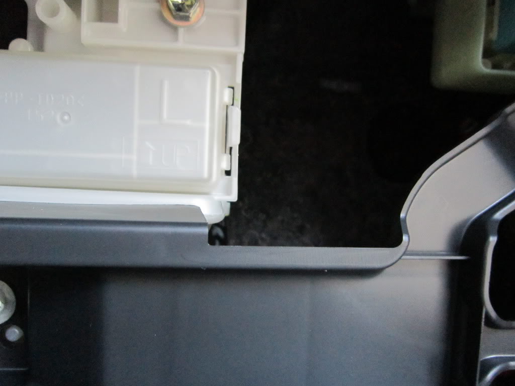

I went to my local Autozone after reading this thread and found a STP filter (CAF1816P) that fits and it's $14. It's not charcoal but you can order a charcoal one from Autozone's website for $25.
There's an arrow on the filter cover pointing up so I just matched the arrows.
