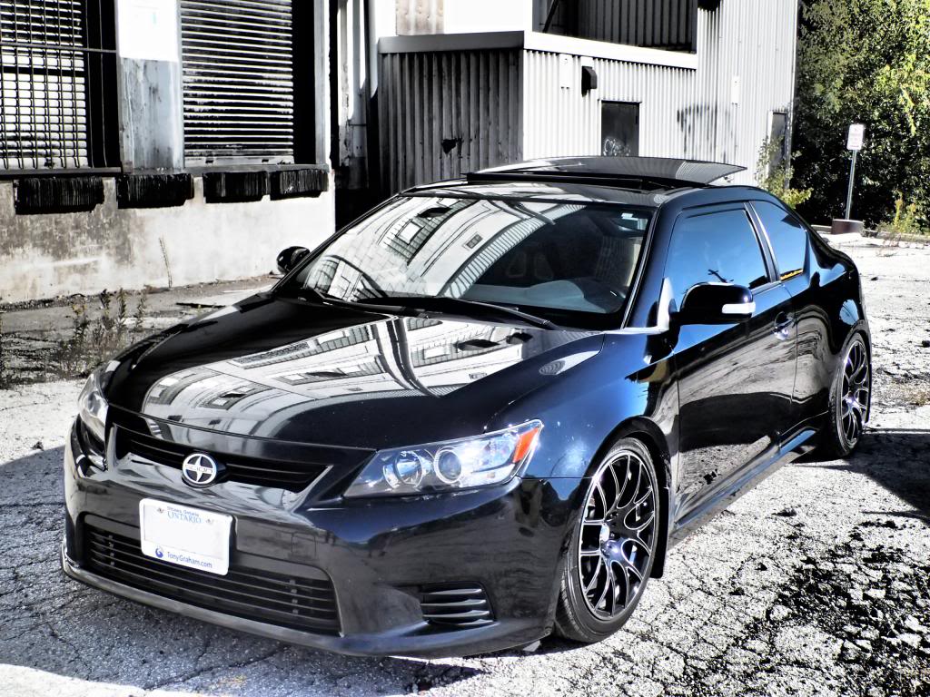

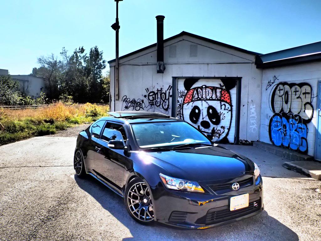

A Quick update, I have just added H&R wheel spacers. Just added 10 MM spacers to the rear. Due to the wheels being pushed out i had to get the wheel arches rolled. After that i was still rubbing over any bump in the road, ended up getting smaller tires. 225/40/18's in the rear. Im really happy with the way it turned out, the wheels are now basically a 18x8.5 w/ +25 offset.
Did a little photo shoot with one of my buddies here in London:
