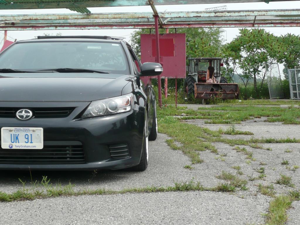

Awesome shooting location! Looks great!

Nice man, i like the fitment and the wheels go really well with your car. The location for the shoot is really good too.
