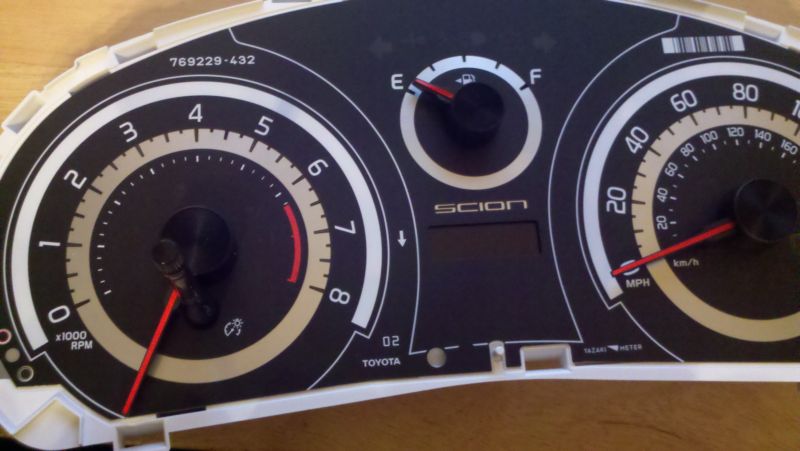

So... I need some help (more than just the psychological kind). I pulled the dash apart last night and managed to move the stopper on the tachometer. I pulled out the cluster gauge, but can't get the indicator ***** (not sure what you'd call them) off so I can pull out the circuit card. I'm hoping I can just move the stopper back in place and fix the problem rather than going back to the dealer.
Can someone give me some help?

Pics of what I'm talking about. Hopefully someone is on here who can help. I'm gonna end up actually breaking something if I keep messing with it.
Thanks!

While I'm sure there are plenty of people on here who are going to roll their eyes looking at this thread, but I GOT IT FIXED.
The motors that run the needles have a range limiter. since the connector is so small, it doesn't take much to slip the thread a notch, effectively moving the limiter into a new position. Pull off the needle, replace it in the correct position and it's as good as new.

i was about to say.. looks like you only bumped your needle and you just needed to remove and realign it..
here i was.. wondering what you were talking about when you said you moved a stopper..

Don't feel bad. I did the same thing 3 weeks ago. Just wanted to count how many LEDs I would need for the swap to another color. Needless to say, I now know that when I do the install, I will place a small piece of tape where the needles rest when off. Also, if I remember correctly, there are 43 plcc leds on the PCB for the gauges.

i took apart dashes on few of my vehicles. moving the arm around 'til you get it bak to the right position is the usual fix. gz & gj =)
