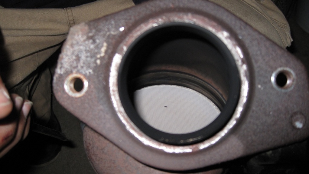

The inside of the stock header's cat...very restrictive!

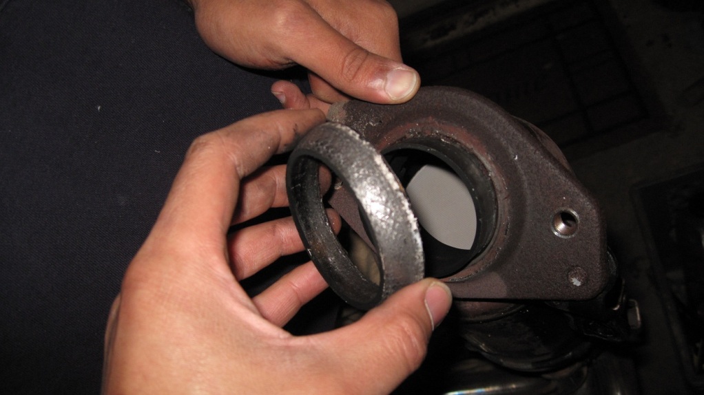

Taking the donut gasket off the stock header:
The inside of the donut gasket is made of like compacted and formed wire material. I frayed it and unraveled it from the inside. This took FOREVER for me to figure out.
