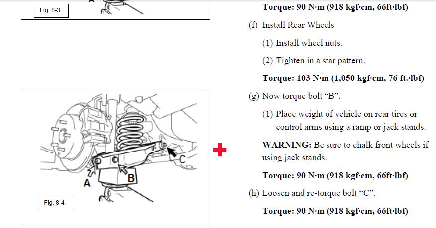

when u installed eibachs did u reuse locking nut on the front struts?
did u tighten the bolts B and C in the rear while it was on the ground?

#1 I really don't remember
#2 Pretty sure I didn't retighten them once the car was on the ground. I followed the exact directions from the TRD instructions and from papa_bear's video....neither of them mentioned tightening them once on the ground.
Why you ask man?

TRD instruction said to put weight of the vehicle on the tires.
Also I was wondering if overtightened/ tightened in the raised position bolt C prevents full travel of the control arm at ride height therefore keeping the rear higher up and NOT giving the proper 1.7" drop

Oh, duh it's right there in the directions. Maybe papa_bear's video was the one that made no mention of putting the weight on the tires.
I doubt it has made any difference though. My car seems just about as low as pictures I've seen of others on S-techs. Are you thinking you're not as low as you were expecting?

well possibly... ill try to do it the right way and we'll see what happens
