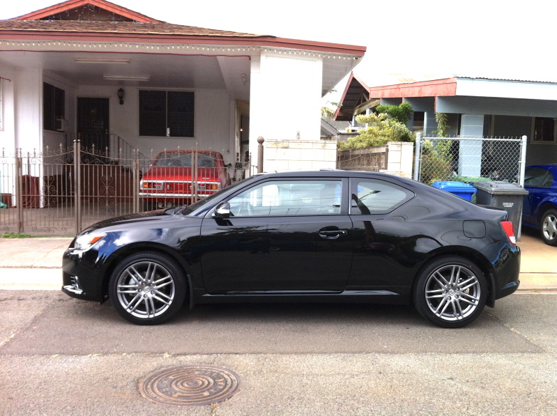

Ok so here it is- more pics to come after the height has settled and i adjust it a little more.. really tired right now lol.
Btw, this car is so brand new that i've only bought the suspension and a windshield sun shade, since i've picked it up from the dealer last week thursday. 233 miles on the odometer- i haven't even bought gas for her yet.. so "de-flowering" a car like this was pretty epic. lol.
Before and After pics.. and again- i apologize for the iPhone quality images.

i really don't like how the front wheel well is larger than the rear- creating a bigger tire-to-fender gap, although i've set it to where the side skirt is level to the ground.. in fact, the rear is a little higher but the wheel gap is still much more pronounced in the front.
loving the feel of the suspension (10kg Front, 8kg Rear) Dampening set to softest setting, provides a very firm/sporty feel.. a little stiff for my friends riding with me, but its my car, lol. taking "spirited" corners, and the car really stays planted compared to the factory lift kit.

Ride Height Numbers as of today..
Measured from ground to arch of wheel well.
Stock:
LF: 27 3/8"
LR: 28"
RF: 27 5/8"
RR: 28"
After the Install:
LF: 26 5/8" (-3/4")
LR: 26 1/4" (-1 3/4")
RF: 27" (-5/8")
RR: 26 5/8" (-1 3/8")
On both sides the front is higher than the rear by 3/8", will be adjusting the RF and LR to match 26 5/8" all around.
Just posting some numbers to get an idea of what you're looking at in the (low-quality) picture.
In case you guys were wondering... YES these babies can go real low, there's proof around the forum.

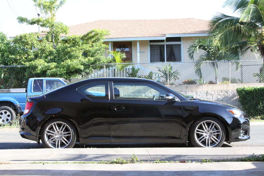

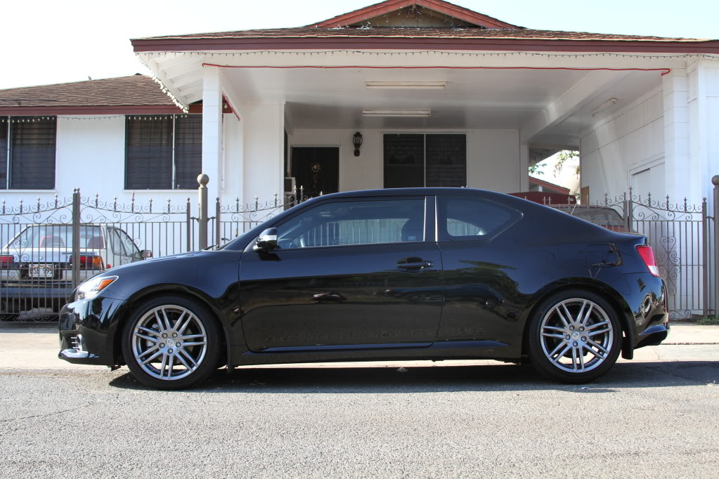

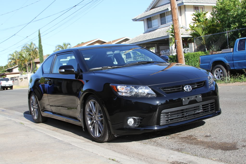

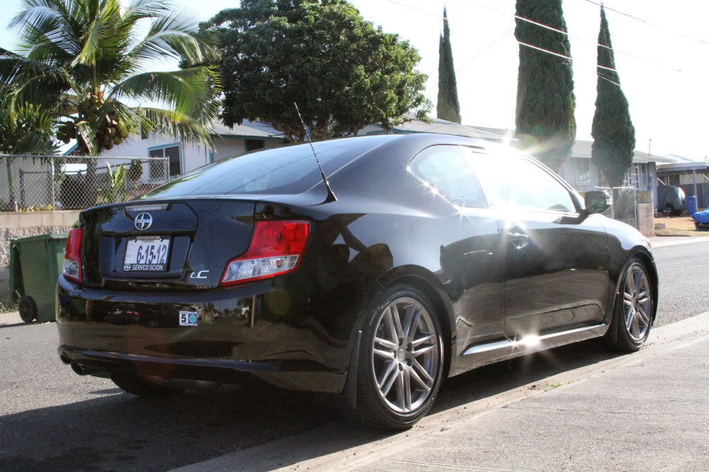

Default New Camera + Clean Car = Pics
