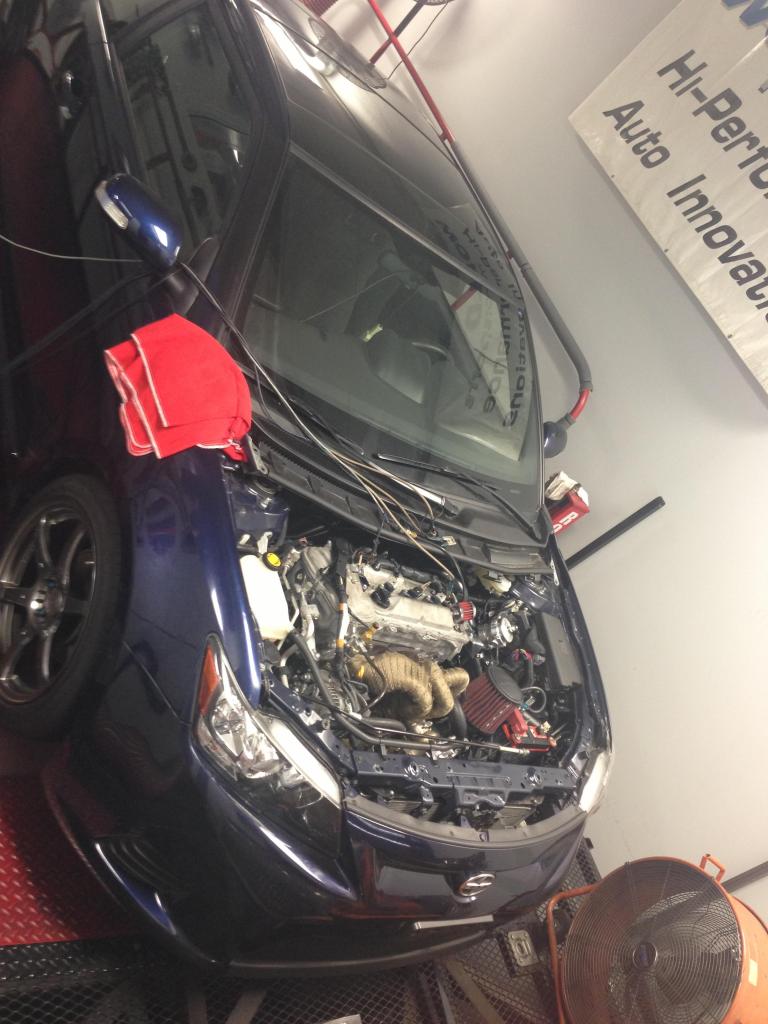

So, in case there are people still wondering about this build:
Last fall this was the car on the rollers getting its final tune. This is after a 3rd rebuild. It was running well. Better than it ever had been.

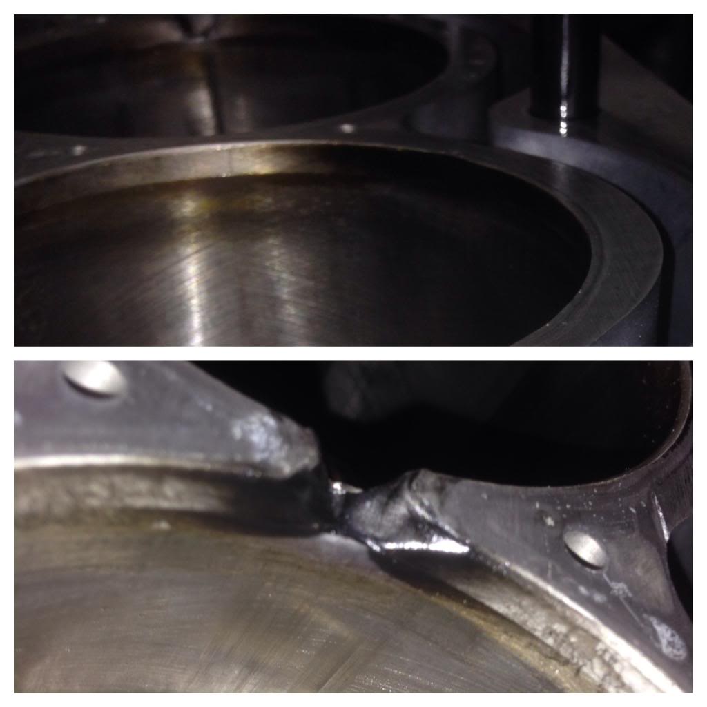

About a week later this happened. Apparently, the cylinders were bored too thin. The iron liners had separated and are out of round from the top deck which caused combustion to escape behind the liners and into the aluminum decking. You can see from top pic that the other cylinders have carbon tracing on and behind the liner. At least, that's what they think.

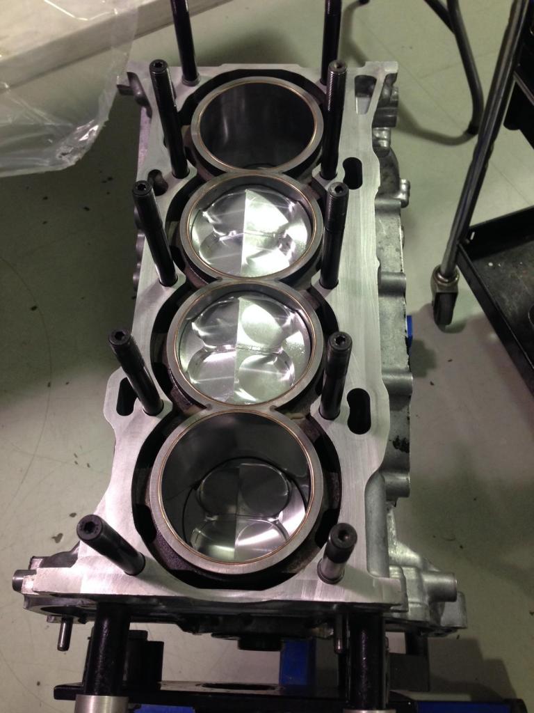

So.... This is short block #4. It's a fully sleeved block with iron to the top of the deck. The head has been sent out and is being milled flat, and drilled for 1/2 inch studs. Also, it's getting a valve job while its being worked on (valves/springs/retainers/etc).
So, there it is. I'm not dead, nor have I given up.
