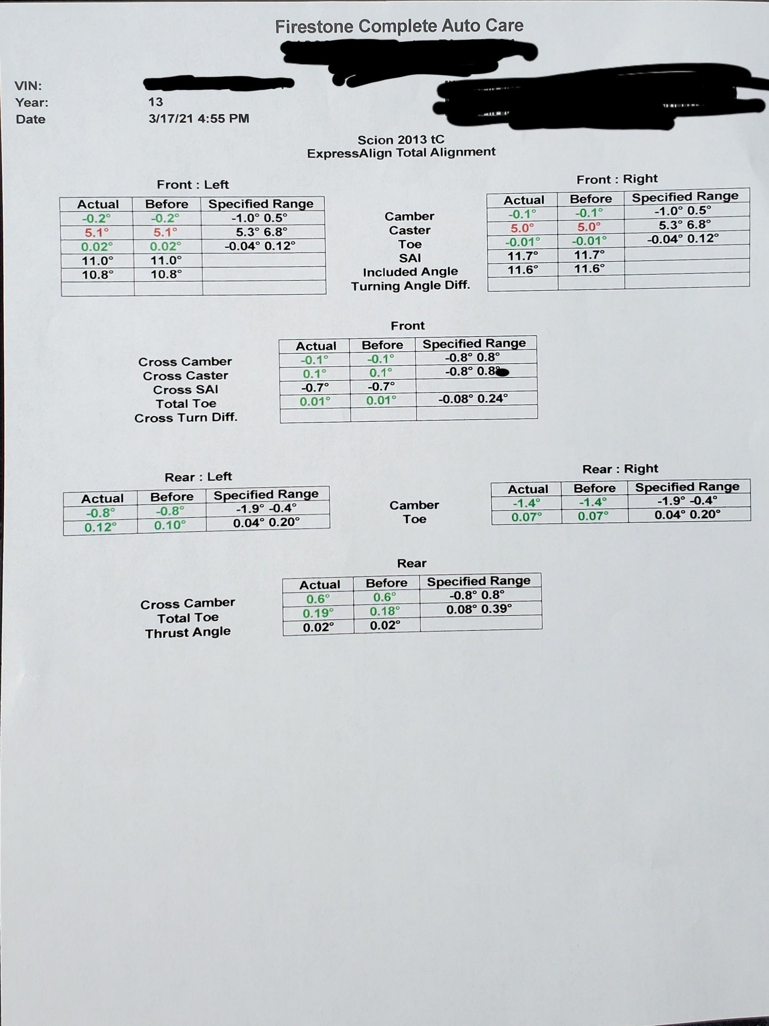

So I had an alignment happened to my car a few days ago but noticed it still pulled towards the right, I went back to the mechanics who did it and they said there wasn't any problems.
I'm wondering whether they're lying to me or there's something internal?
I'm asking if the Alignment info for my car is as it should be or close enough for a tC

Roads are crowned to pull right for drainage and so you don't swerve into oncoming traffic if you fall asleep. Try testing on a few different roads. You do have a little more negative camber on the passenger rear which will slightly pull that tire to the right, but it's non-adjustable stock. Looks like they tried to correct the thrust angle with the rear toe. Overall looks pretty decent considering Firestone did it.
