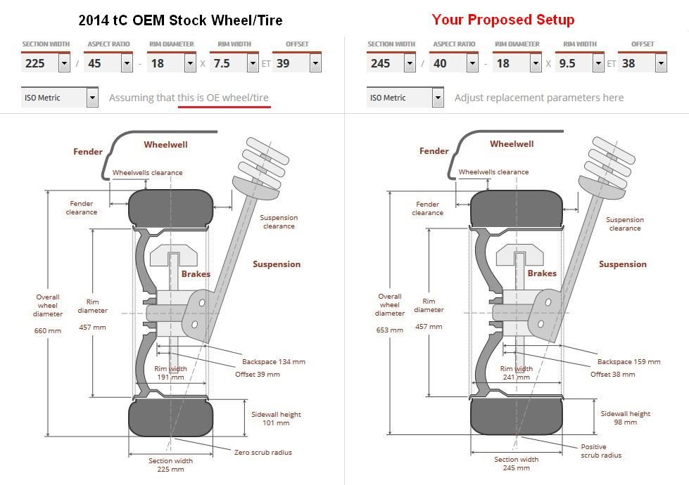

Looking to get a set of AVID1 AV-06 Bronze Wheels, I don't like the wheels sticking out look so looking to go with a 38 offset but the only rim I can find is a 18x9.5 with 245/40-18 tire.
Anybody know if these will rub in the turns with basically the stock rim offset? I think the stock offset is 39.
Thanks.
