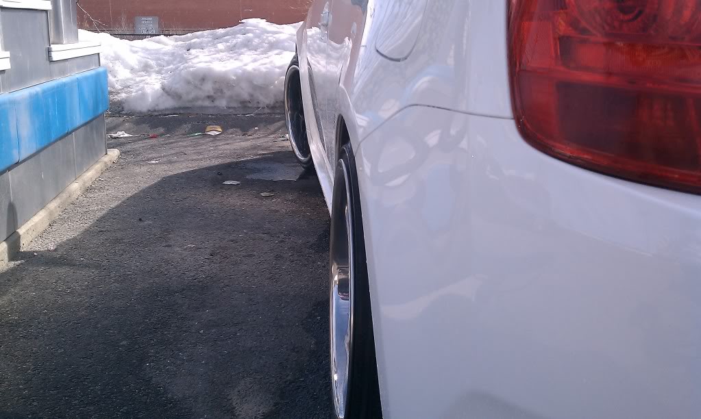

Semiflush:

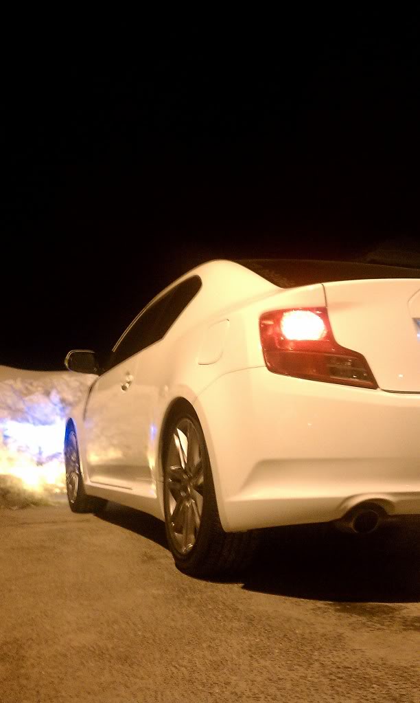

Advan Kreuzer 18x8 225/45/18, 18x10 235/45/18 (i forgot the offsets)
