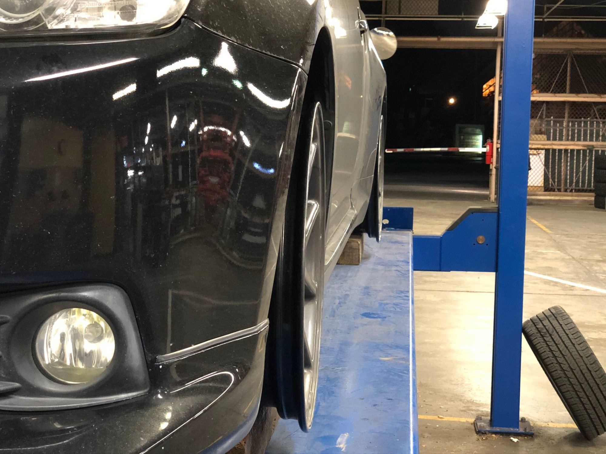

Tesla Model 3 Aero wheels, these are what’s under the wheel covers.
18x8.5 +40 offset 64.1mm center bore.
Waiting on my tapered lug nuts (conical seat on the Tesla wheels) and hub centric rings to come in before installing. 235/40R18 tires will be going on them.
Currently have 5mm wheel spacers up front in the pics. Thanks for looking!
Side View:
Rear Profile:
Front Profile:

Wheels fit well, would fit even better with 15mm spacers all around ;)
