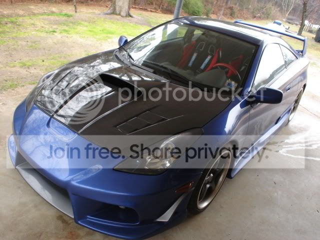

260 is a bit overkill on sanding grit, any good 600-800 will be fine and you shouldn't have to use as much paint to hide the sanding scratches. i did this on my celica way before the scions ever came out. i used just regular car paint when doing it.

the stuff i used was called bulldog adhesion promoter, we get it at the body shop where i used to work, never had any problems with flaking. never used the krylon fusion though.
