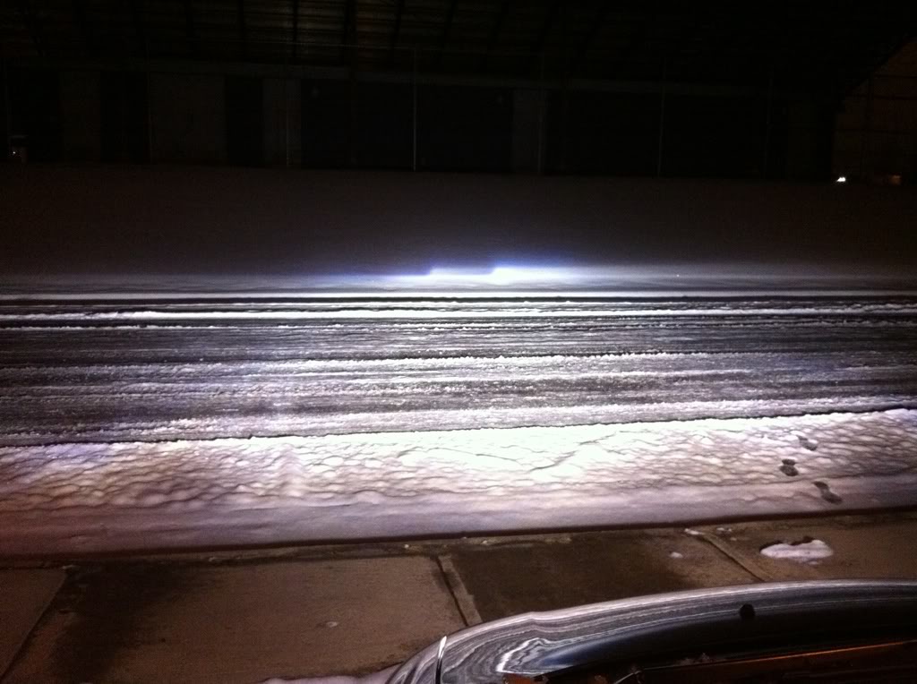

stock headlight assembly
no black out reflectors, as I try to look as OEM as possible
bi-xenon (high beams and low beams) projectors from Infiniti FX35/45
swapped in clear projectors lenses to let out more light and sharper cutoff
OEM philips 85122+ bulbs boosted to 50w using Morimoto ballasts
E46R-extended shrouds to cover the projectors

Looks good!!
Must be such a big difference driving at night compared to stock.
Nice choice of components also.

thanks! yea i chose the FX because a friend that worked at nissan gave it to me
I was originally going with LS430s for the widest beam ever, because there's so much room to work with, I don't even care if i lose high beams. But $400 just for projectors, my budget said otherwise. Maybe in the future though.
