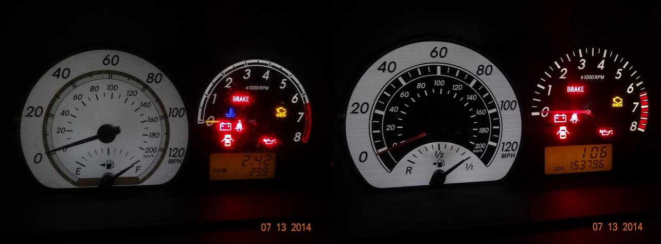

*reviving a thread from 7 years ago but might still be useful to the xA lovers
Just did this tonight, it's not very hard to put the 06 gauge faces into the 05 cluster, the only real problems is taking out the light defuser on the 05 cluster still doesnt light up the needle of the 06 like it should (but it is still sort-of lit up). and also its really easy to get finger prints on the gauge faces continuously re-calibrating them until you get them good enough but pretty hard to get the finger prints back off without leaving streaks.
The 06 cluster was actually 13k less miles on it, I should have just stuck it in as-is and said to hell with it but it would drive me crazy knowing that it wasn't correct
Here is the before and after since no one has put any yet
Attached Thumbnails 2006 Gauge Cluster in an 04/05 xA?-before-after-cluster.jpg
