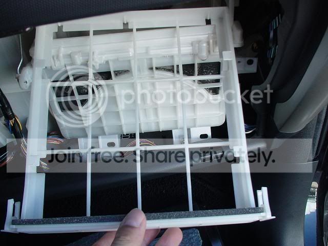

i was tryin to clean my a/c filter
so i opened it and bam
theres no filter
theres only plastic frame...
am i supposed to have filter thingeee? right?

just like that...the filter was not included...I never would have known myself until I saw about this diy filter almost a year ago...

I'm not sure... my tC has the location, but nothing inserted for it as well... people have made DIY filters for them with good results, but you do lost a bit of cooling flow... and that's why I think they left them out... better cooling without...

If that is the filter inside your glove box it is a cabin air filter. You can buy one at Kragens for about $12. They fit the xA, xB, and Rav4. There are a few posts on making them. If you buy from Toyota they are over $30. Not sure what stores you have available in Guam--so you might want to look at the DIY section.

The cabin air filter is an optional extra just like floor mats. The dealer has 'em (overpriced at most dealers) or you can make one yourself - the DIY instructions are in the tech section here.
My xA and xB Both have cabin air filters - one is a genuine Toyota, the other is home made. (No, neither came with.)
See https://www.scionlife.com/forums/viewtopic.php?t=20753

Just take all the crap out of the glove box, squeeze in at the back of the opened box and once you get it out, there is the white plastic you saw above. The spot for the filter will be at the top. You can even do this with your dad in the drivers seat because you don't have to worry about him being right that one is in there.
