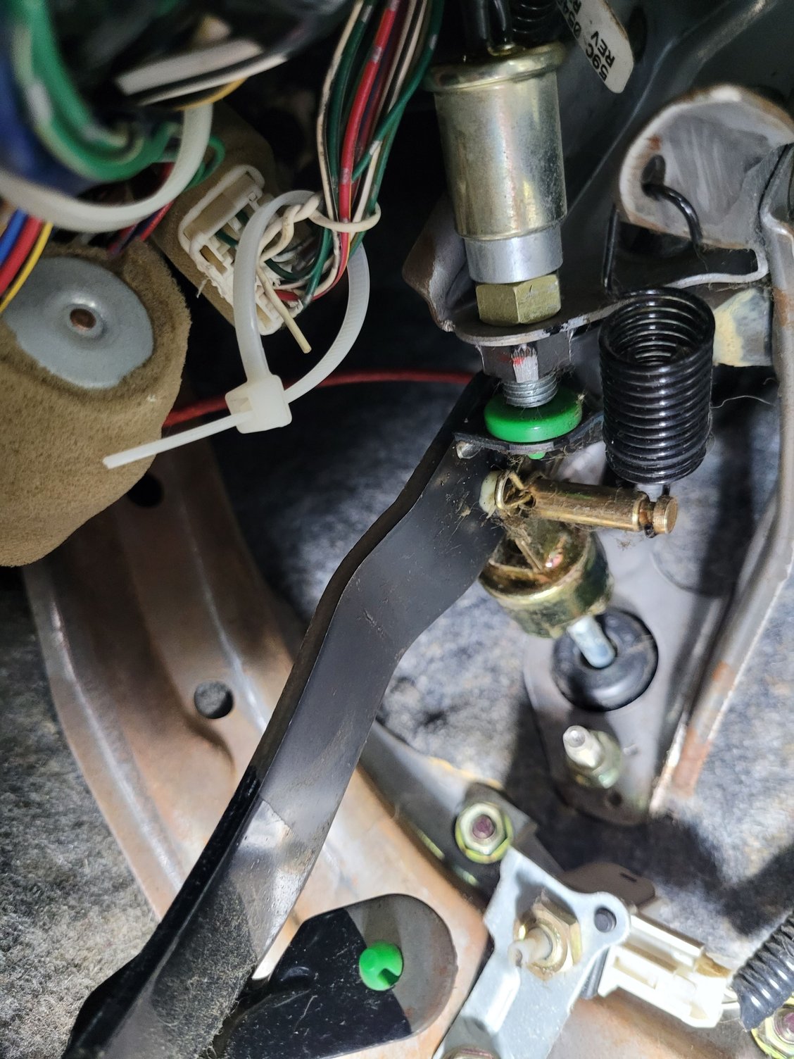

My issue is the wire on this plug(with the zip tie) keeps loosing contact (it's right behind the fuse panel) it's a red with light blue tracer, but the heat warmed up the insulator to a nice brown color, that really threw me for a loop the first time around...
