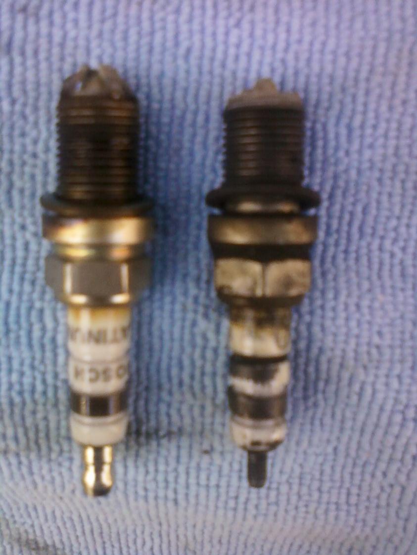

Originally Posted by wutie
yes i am! codes 300, 301, 302, 303 cylinder and random misfire. toyota dealership wouldn't tell me EXACTLY what it is though. but of course they will for another full diagnostic -_-
i plan on changing all spark plugs, wires, and coils. hopefully that will fix all problems.
Didn't pull any codes just replaced plugs due to hesitation in acceleration. This is what I found on cyl #4 (plug was also not tight as cyl #1-3) scared me but runs fine with new NGK's. These are Bosch platinum +4 plugs. Plug on left has groove burned all the way around loosing compression and you can see the etched ceramic , also burned off the 4 ground legs and blew soot all over boot. Glad to report oil change at 150K miles and ready to flush coolant for winter driving.
