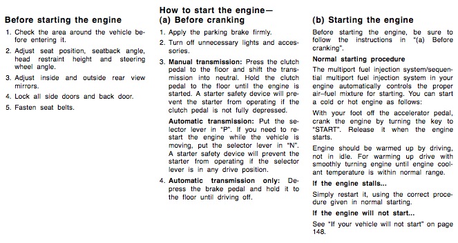

One month old standard transmission xb with 2500miles...
With the manual transmission, the clutch has to be firmly pressed all the way in or nothing will happen...
I've even seen folks with poorly anchored floor mats that kept the clutch from going in all the way when it bunched up behind the pedal...

dude, it really sounds like the clutch pedal switch wasn't engaged. If you are sure it was, then it needs the switch. I am a tech with Acura, and I know if I was looking at your vehicle, and I couldn't duplicate your problem, I just would replace the switch under warranty as an intermitent fault. But having the vehicle with full power and nothing happening at all when cranking was attempted, that would have to be it. Your crank position sensor, any relay, or anything else you would hear a click, or a crank but no start, or something. But I don't work on Toyotas and mine only has 400 miles on it, and no such problems (standard trans.), so I could be wrong.

The manager said it was the floor mat that was interfering with the clutch and the switch was not engaged.
