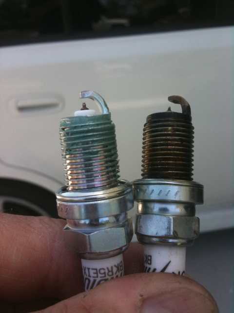

Wanted to post a pic of the Iridium plugs after (oops!) 41.8k mikes. No, not 41.8k on the odo, but on the plugs themselves. Installed 1/20/08 (see first post) with about 30k on the clock. Still ran fine, started great, no issues. Scion tough-Scion quality!
You can see the wear on the side electrode especially. Even the Iridium tip is worn because it is so much thinner and the end is not sharp and square any more. Unless the newest version sports a thicker center electrode.
NGK Iridium - Part no. BKR5EIX-11. Comes factory gapped at .044. The worn ones have to be at least .055 or .060!
