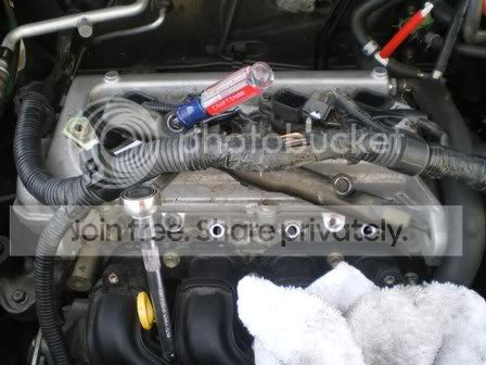

If you haven't already start by clearing the codes and see what happens maybe you are in a limp type of mode. If you want to swap the injectors you don't need to pull the valve cover just take off the 2 bolts holding the wires above the fuel rail and remove the 2 bolts holding the rail to the head the rail will then just pop off. Make sure you have a rag nearby to soak up any spills. I can swap injectors in under 10mins so it's easy enough!

well thanks man but i have already cleared the codes with a scanner several times and also cleared them by removing the positive batt terminal for about 20 minutes... the reason why i thought u have to take the valve cover off if because there's a hook type thing that is part of it hanging over the fuel line i did remove the 2 bolts and i moved the wiring harness out of my way i got them to move a tad but i then saw a bunch of dirt and trash down beside them so i didn't go to yanking on it.... maybe your yr model doesn't have that "hook" over the fuel line... maybe i'm just scared to break something

They all have the hook, you can lift the rail and pivot it enough to clear all the injectors. I use a bunch of q-tips to clean the gunk out from around where the injectors go. I'll get a picture up in a bit.

cool thanx! don't need pix but if u wanna then go ahead

well thanx for tha pic i'm about to go and try this injector swap.... got my fingers x'd
