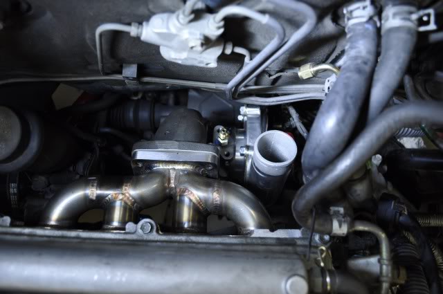

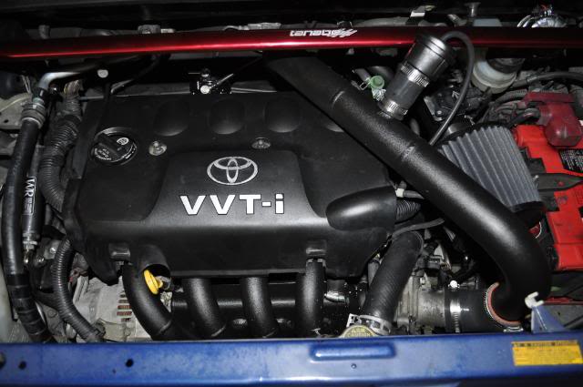

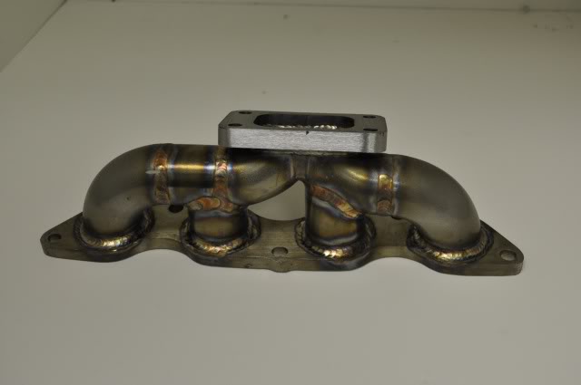

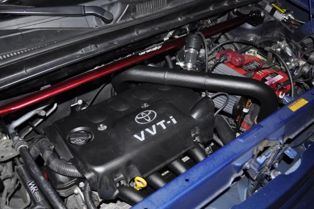

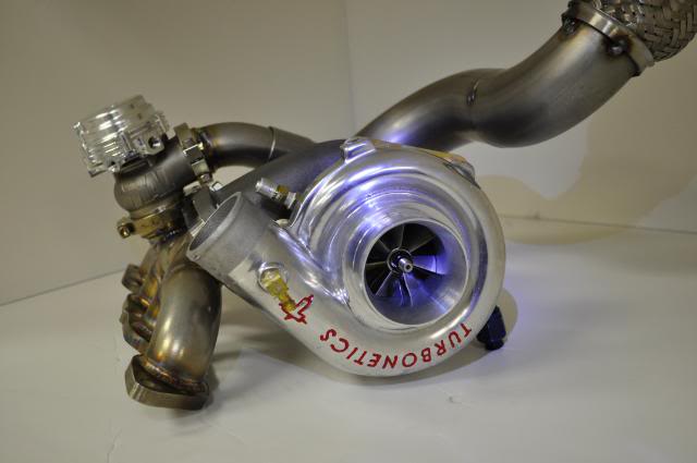

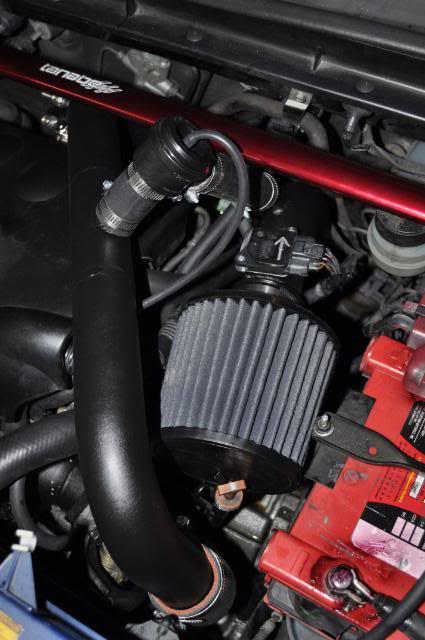

Hey everyone, please feel free to contact myself, Kareem or Mike at WORLD Racing if you have ANY questions in regards to your TURBO SCION xB1. We just launched our very own DESCENDANT turbo kit but can help ANYONE with their questions even if you have SOMEONE ELSES turbo kit! Call us at 310.533.8900
For now please let me introduce the new Descendant xB1 "Tuner Friendly" turbo kit.
Installed Pics:
*pre wastegate. Manifold in kit includes TiAL Sport MVS Gat
Products Pics:
*pre wastegate. Manifold in kit includes TiAL Sport MVS Gate
