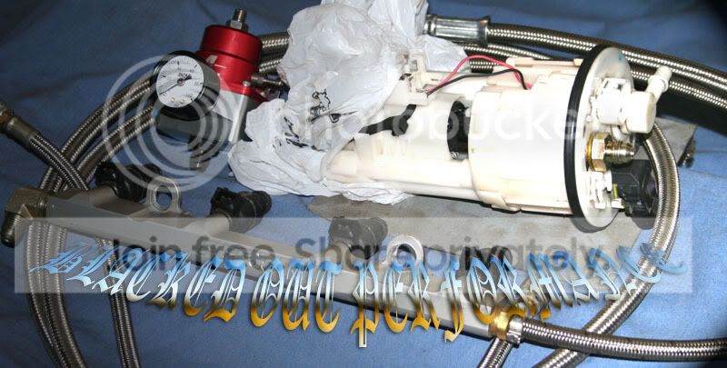

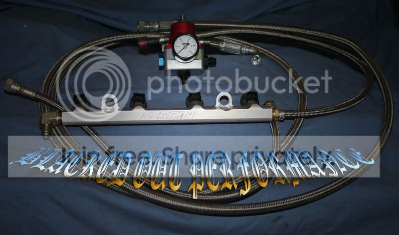

You might be beating a dead horse. The shop I go to put a full fuel return system for Xa/Xb boosted application in my Xa about three months ago. I believe it is available for Sale but I have no Idea on price. I put my car away for the winter so I don't have it easy access to give you an installed picture. I will be able to drive out to storage and take a pic in the next few days. It is snowing and my ride is stored in B.F.E.
Strict Fab has the Blacked Out Performance Kit. Mine came with Perrin fuel rail, Aeromotive FPR, B&M gage. All lines are stainless steel braided. The lines and fittings are good up to 1000 psi (hydraulic line and fittings) so they are pretty muck indestructible. Also comes with the bulkheads, warlbro 255fuel pump, and RC 310cc injectors. They added the pump, rail and injectors because the stock injectors, pump and rail could not handle the extra fuel flow. The stock stuff could not give me what my ride needed with an 8psi turbo setup so they replaced it all.
The whole thing is bolt on minus one hole that needs to be drilled in the plastic fuel pump assembly. I have the first pics of the gear they sent me in email to show me what they were putting in my car. I will call them to get a price on just the fuel system.
I don't know the price since mine was included in the custom T-28 turbo kit I had Strict Fab do for my Xa.
